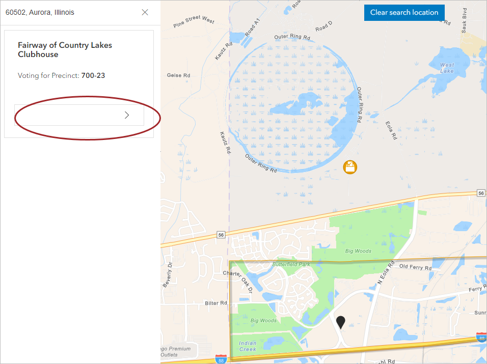

The Election Polling Places app uses the Zone Lookup Instant App to help voters search for their address or poke on the map, then displays precinct and polling place information for the chosen location. If your Election Polling Places app is not displaying polling place information, it may require configuration. Future deployments of the Election Outreach Solution will not need this configuration.

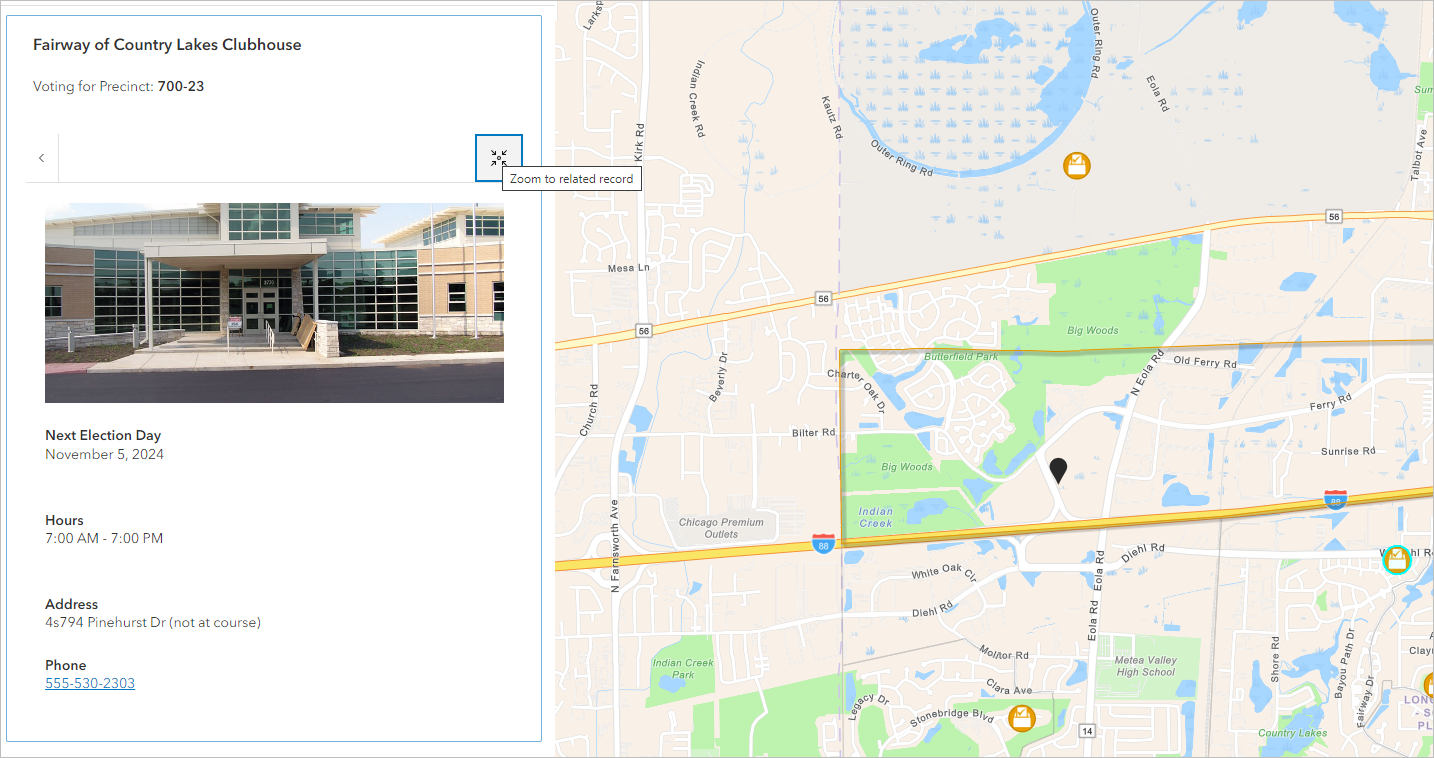

The Election Polling Places app will now display the polling place's information in the related record pane. However, voters must click on the related record pane to view details. In the next section, use a URL parameter to help voters discover polling place information more quickly.
Add the related record URL parameter
The Election Outreach Solution includes the Promoting Transparent Elections ArcGIS Hub site where voters can access the Election Polling Places app. Your organization may link to the Election Polling Places directly from your organization's website. Wherever voters access the Election Polling Places app, you can add &openRelatedRecords=true to the hyperlink. The resulting URL would look something like this:
https://www.arcgis.com/apps/instant/lookup/index.html?appid=88489793f68f462ea87dfa3aa9440850&openRelatedRecords=true
This will open the related record (polling place) without having to click. If you'd rather not append it as a URL you can use a tool like ArcGIS Assistant to edit the apps data to set this option. Learn how to configure the apps data, here.
