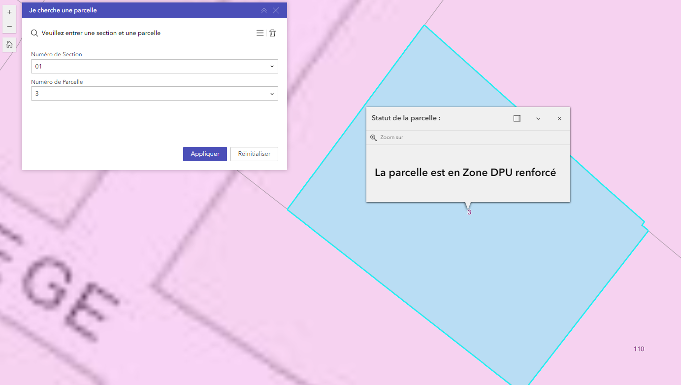

I needed to build a small application using Experience Builder to allow my users to search for a plot by number and check if it was located in a special zoning area for building permits. I had difficulty finding a simple and effective solution, so I am sharing it with you today.

- A Web Map containing my "plots" and "areas" layers.
- An Experience Builder application with a query widget allowing the user to enter their plot reference (in 2 fields).
- The use of an expression in the pop-up window to check the geometric intersection between the two layers.
- The use of a "text" type content for displaying the result of the expression in the pop-up window.
(Thank you to Kelly Gerrow : https://community.esri.com/t5/arcgis-online-blog/overlapping-features-in-pop-ups-quick-introduction/bc-p/890927#M498)
- Enabling the "Show pop-up upon feature selection" map option in Experience Builder.

Here is the result (in french sorry) :
