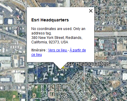

We have a script that generates a KML file with a placemark that only have an <address></address> tag (no coordinates). When added in Google Earth EC :
- The address is geolocated and a pin is added on the globe
- The user can zoom to it with a double-click

And the result in Google Earth EC :

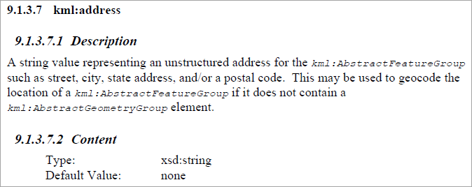

The OGC KML 2.3 standard states this about the <address> tag :
It would be great if ArcGIS Earth could also make use of the KML <address> tag.
