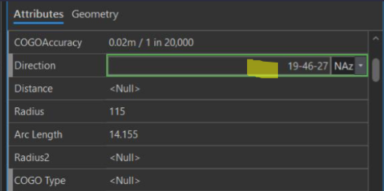

Our organization receives plans in with radial bearings defining the direction of the curve. Once entered, the parcel fabric in ArcGIS Pro stores this information in chord bearing. We have no issue with the fact that this is stored in chord bearing, but once stored, there doesn't appear to be an easy way to identify the radial bearing of a curve anymore. We would like a tool (perhaps something on the Parcel Utilities Add-In?) that, when we click on a curve, provides all the curve parameters. Or, similar to the Traverse window, where you can specify curve parameters, can this be an enhancement to the Attribute Window for once the curve has been entered?

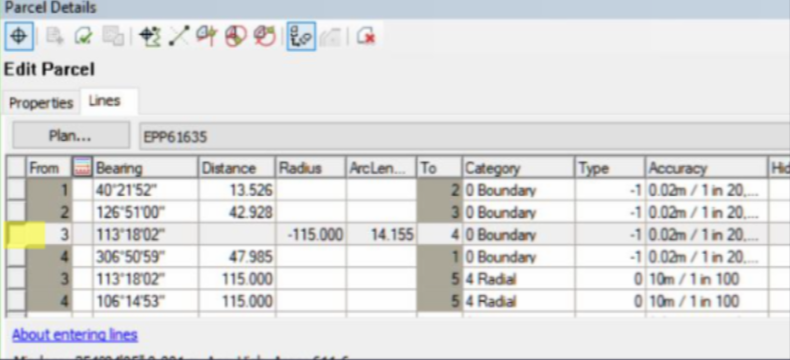

Our use case for this is: we had a parcel with a high misclosure and we couldn't figure out why. It turned out to be due to a bad curve bearing, but this was very hard to identify, since the plan displayed radial bearings and the lines in the fabric displayed chord bearings. In ArcMap, we would have opened the parcel, which would have showed us the radial bearing since those would have been the properties stored on the plan. Then we could easily compare what was entered to the plan. We would find it helpful to have something that allowed us to do this in ArcGIS Pro.

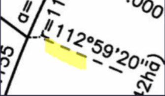

that radial line in shown in desktop
needs to be this according to plan
but you only get the chord in ArcGIS pro so I have no way to enter a new radial
