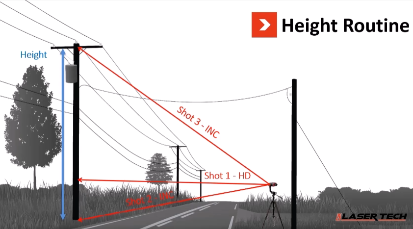

Height routine
To measure the height of an object you use a 3-shot routine. You can measure the height of trees, poles, buildings...

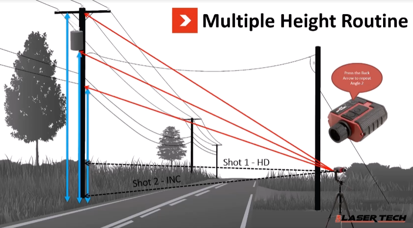

Multiple height routine
A variation of the height routine, where you can collect multiple height measurements along an object. In the illustration below, the routine measures the height of the transformer and the pole. In this routine, you can calculate as many heights as needed along the object.

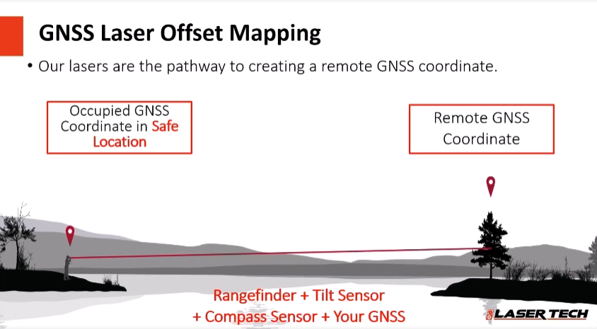

Offset Mapping
This is a one-shot routine where the location of a remote asset is calculated. In this workflow, the laser rangefinder must be able to measure distances and also the azimuth to the remote object. Survey123 provides the source location from which the measurement is made.
For offset mapping workflows one important consideration is accuracy. The laser rangefinder will very accurately measure the bearing (azimuth) and distance to the target object, but to complete the calculation of the remote location the position from which the measurement is made is also needed. The source location could come either from the built-in GPS on your Survey123 mobile device or from a high accuracy external GNSS receiver connected to Survey123.

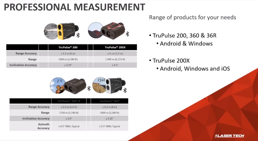

The Survey123 team has been closely working with Esri Partner Laser Tech to integrate the TruPulse series of laser rangefinders. There are a variety of models in the TruPulse series, each with its own characteristics and OS support.

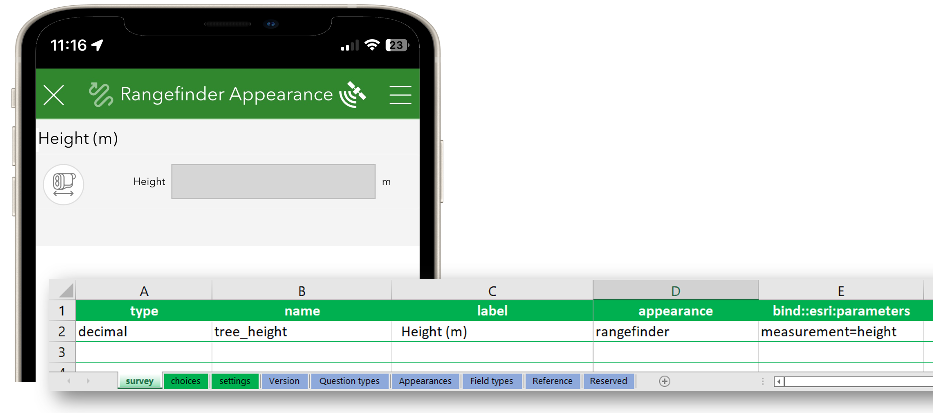

XLSForm expressions for TruPulse laser rangefinders
The XLSForm syntax has been expanded in Survey123 so you can bring TruPulse measurements into your Survey123 forms.
Below is a very simple example: Note how the rangefinder appearance is used here to allow the end user to gather a height measurement from a TruPulse device. The bind::esri:parameters column determines what type of measurement routine will be executed in the laser rangefinder. In this case, the rangefinder will return a single value so we use a decimal question type to keep it.
For more complex measurement routines, such as multiple height or offset mapping, the output from the rangefinder will be handled in your XLSForm logic as a JSON object. To learn more about the details of XLSForms for TruPulse integration check out:

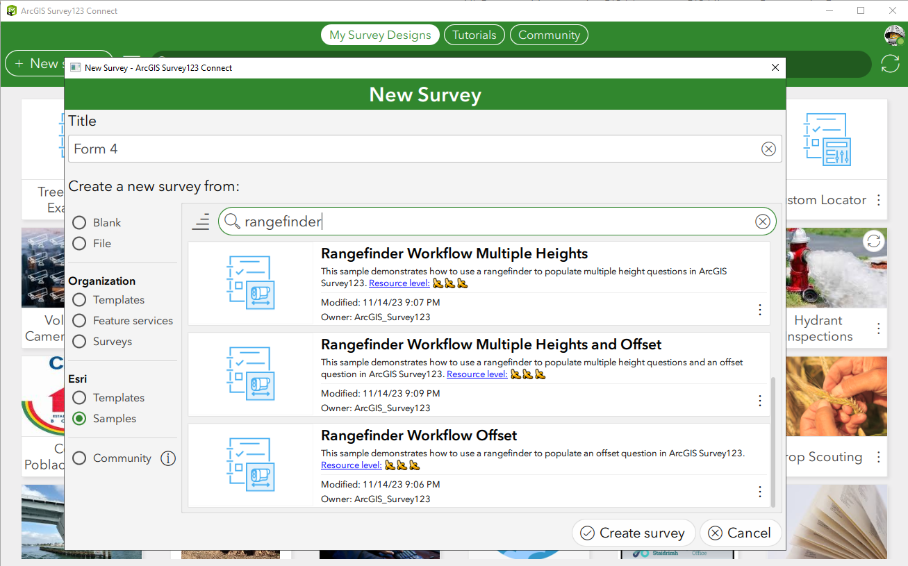

Below is an example of the various XLSForm samples in Survey123 Connect. There are 6 of them
