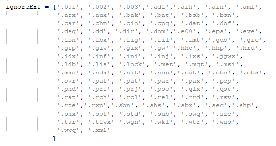

Using os.walk(), I myself have figured out a way to filter out GIS files, but it took a long time to figure out and required me to:
- arcpy.ListFiles
- Filter that list through my list of extensions to ignore
Note: There are 96 extensions here and I know for a fact I'm missing several more that I need.
