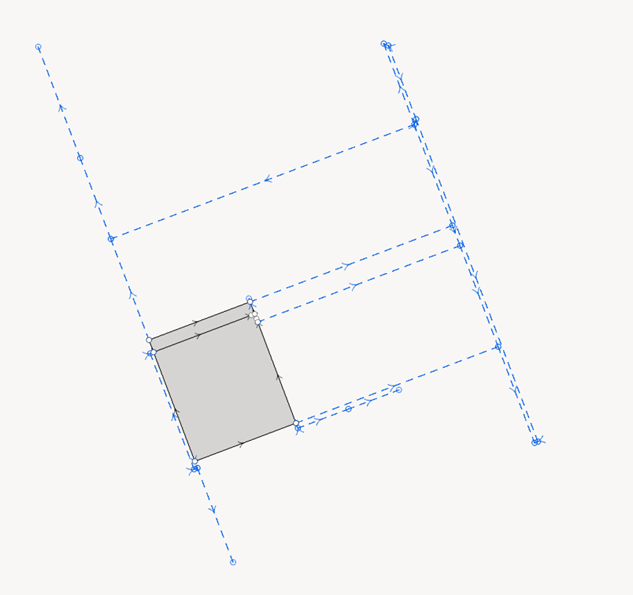

Since most plans that we receive have additional linework, we would be required to use this workflow frequently, and although it is functional it is a cumbersome process when working with parcels with many connections, for example the following:

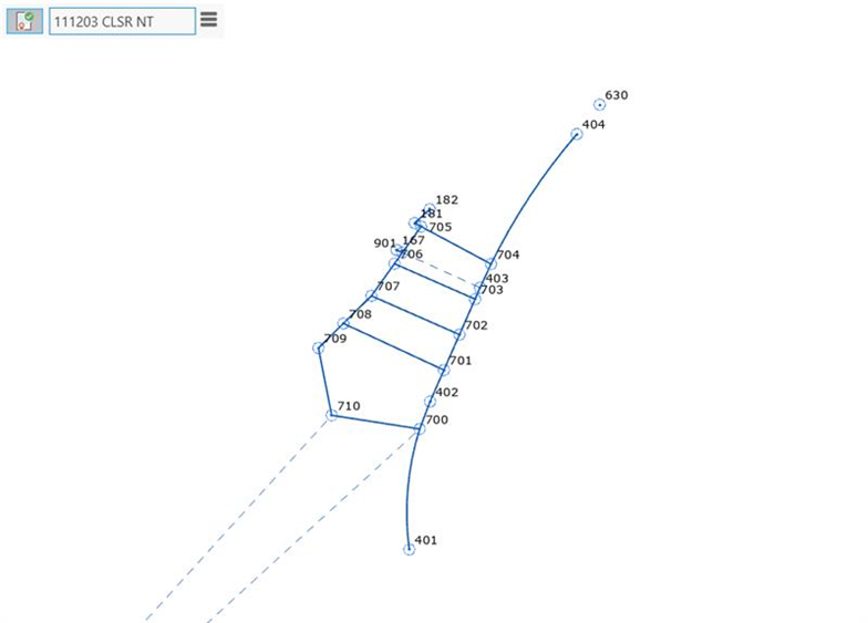

As an example, you can see in the image below that the plan goes beyond the boundaries of the four new parcels and resurveys some boundaries and some connections.

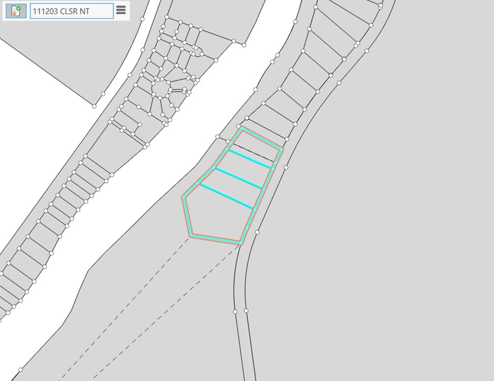

When the alignment buffer is created, some of the additional lines fall outside of it, which results in some of them moving while others stay where they are. Since these are all being brought in on the same plan, it is necessary for them all to move in the alignment.

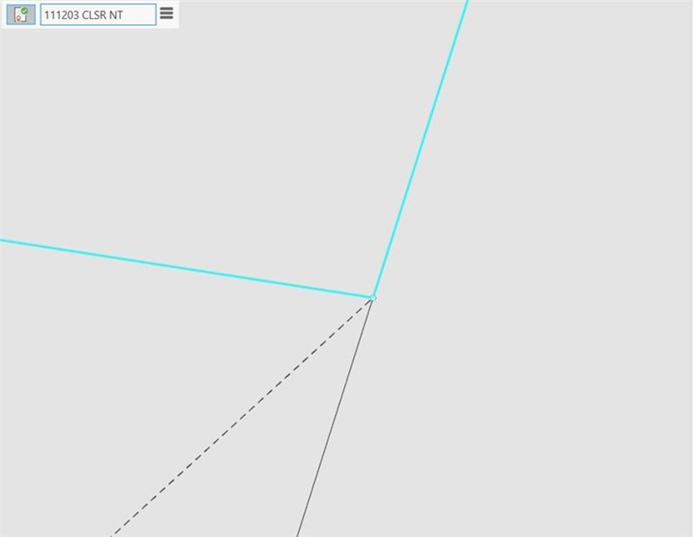

After the align (within the buffer):

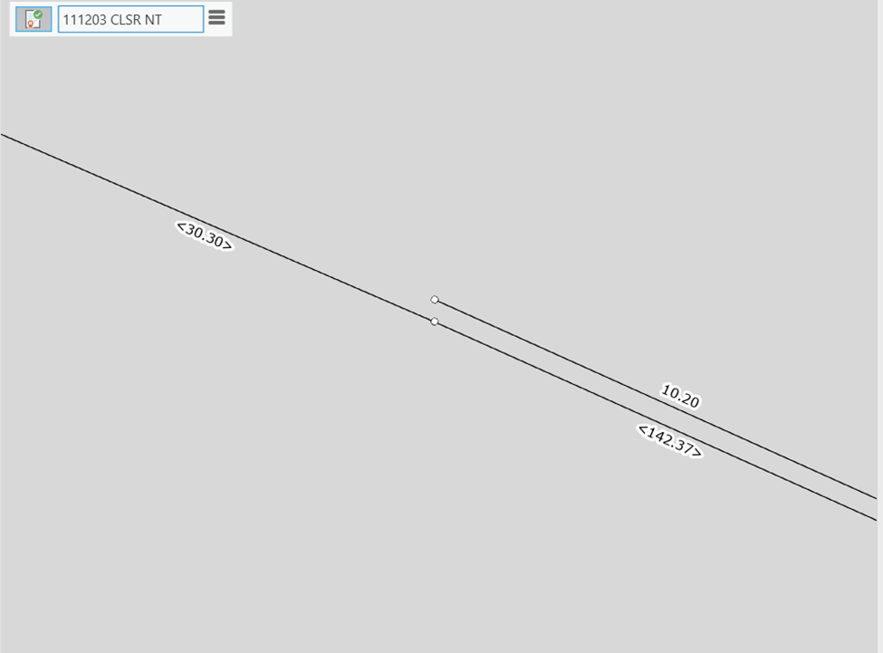

After the align outside the buffer:
