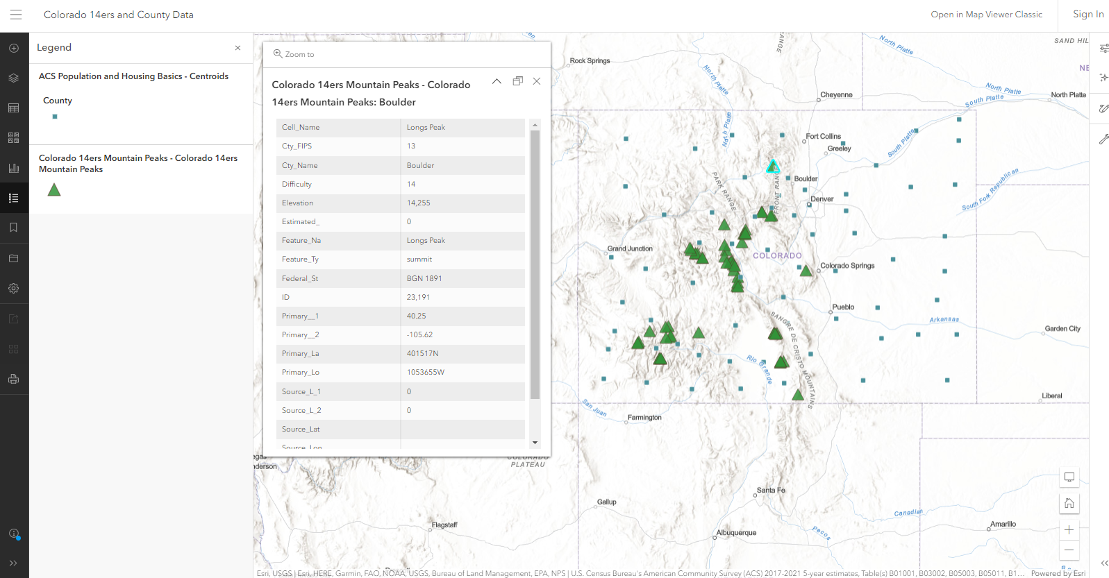

To the left of the map, use Layers > turn off the ACS layer > so that only the mountain peaks are visible. If you open the table of data behind this layer, you will see that 58 records exist, corresponding to the number of peaks that meet this elevation. You will also note that a field exists called Elevation, and another field exists called Difficulty. The difficulty are ranked from 1 (most difficult) to 58 (least difficult). The criteria used to generate the difficulty includes (1) climbing duration and challenges inherent in the trek, (2) terrain stability, (3) cliff exposure, (4) presence of a trail, (5) elevation gain, and (6) total roundtrip hike distance. Thus, the difficulty is really an index that incorporates 6 different criteria.

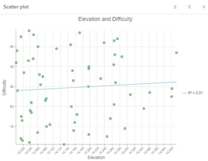

Is there a relationship between elevation and difficulty? To find out, you will create a chart and create a coefficient of determinations fit on that chart. To the right of the map > Configure Chart > Add Chart > Scatter Plot > Data > X-axis: Elevation. Y-axis: Difficulty > Show Linear Trend (the coefficient of determinations) > observe your chart (shown here). Hover your touchpad or mouse over some of the points on the scatter plot to observe their values (elevation and difficulty).
Based on what about you know or may need look up about the R squared value and what it means, is there a relationship between difficulty and elevation? How strong or weak is it? Why do you suppose this is the case?

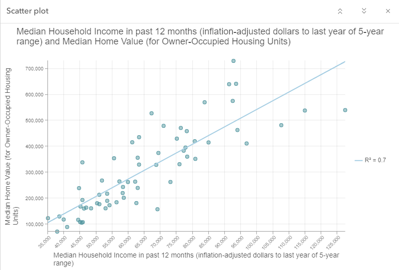

Next, turn on the layer ACS Household Income Distribution Variables > Expand > County > Configure Charts > Add Chart > Scatter Plot > X-axis: Median Household income in past 12 months > Y-axis: Median Home Value for owner-occupied units > Show linear trend (shown here).

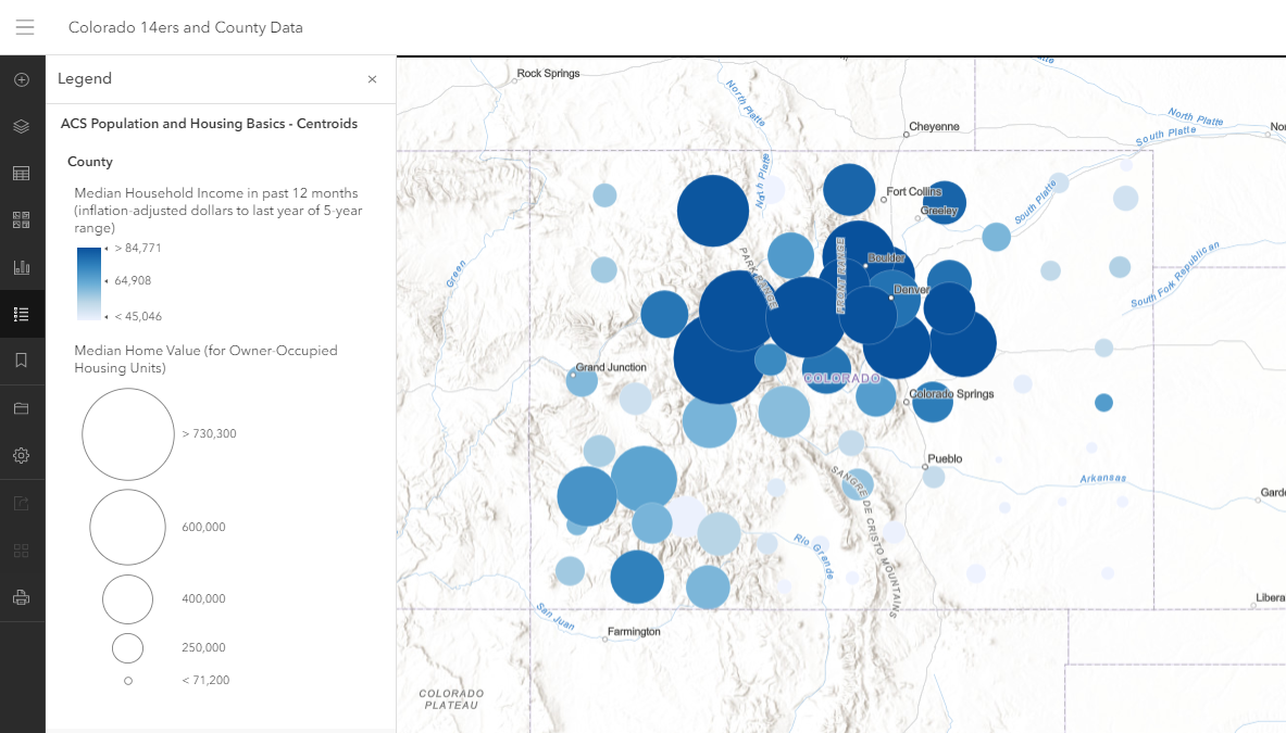

The map of this data is here:
Based on what you learned in your courses about the meaning of the R squared value, is there a relationship between median home value and median household income? How strong or weak is it? Why do you suppose this is the case? Do you think the same relationship would exist for other states?
Note the presence of mountains in Colorado from the presence of 14-ers and the shaded relief base map that is in use. Traditionally, it has been more expensive to build homes in the mountains and to be able to afford to live there. Use your mouse or touchpad to click on a point in the scatterplot where the home value is high and the household income is high. Use the shift key to select additional points (or use shift-and-band an area on the scatterplot to do so). Use the “lower” symbol to minimize the area occupied by the table so you can see the map. Where in Colorado are these higher income and higher home value areas? Do they correspond with the most mountainous areas of the state? Conversely, repeat this procedure for the lower income and lower home value areas in the state, noting any geographic region(s) in the state in which these are concentrated. Do these areas correspond to the Great Plains region of Colorado to the east and the canyons and high plateaus of the northwest part of the state?
