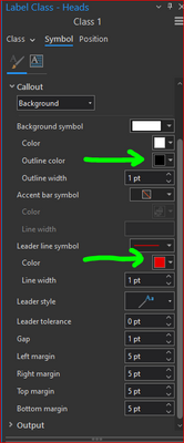

Final clarification, I'm looking for an expression that controls the options below.
I've been told that using a popup, with HTML is an end around. This didn't work for me, as they need to be persistent in layouts and need to label engine to avoid overlaps.
