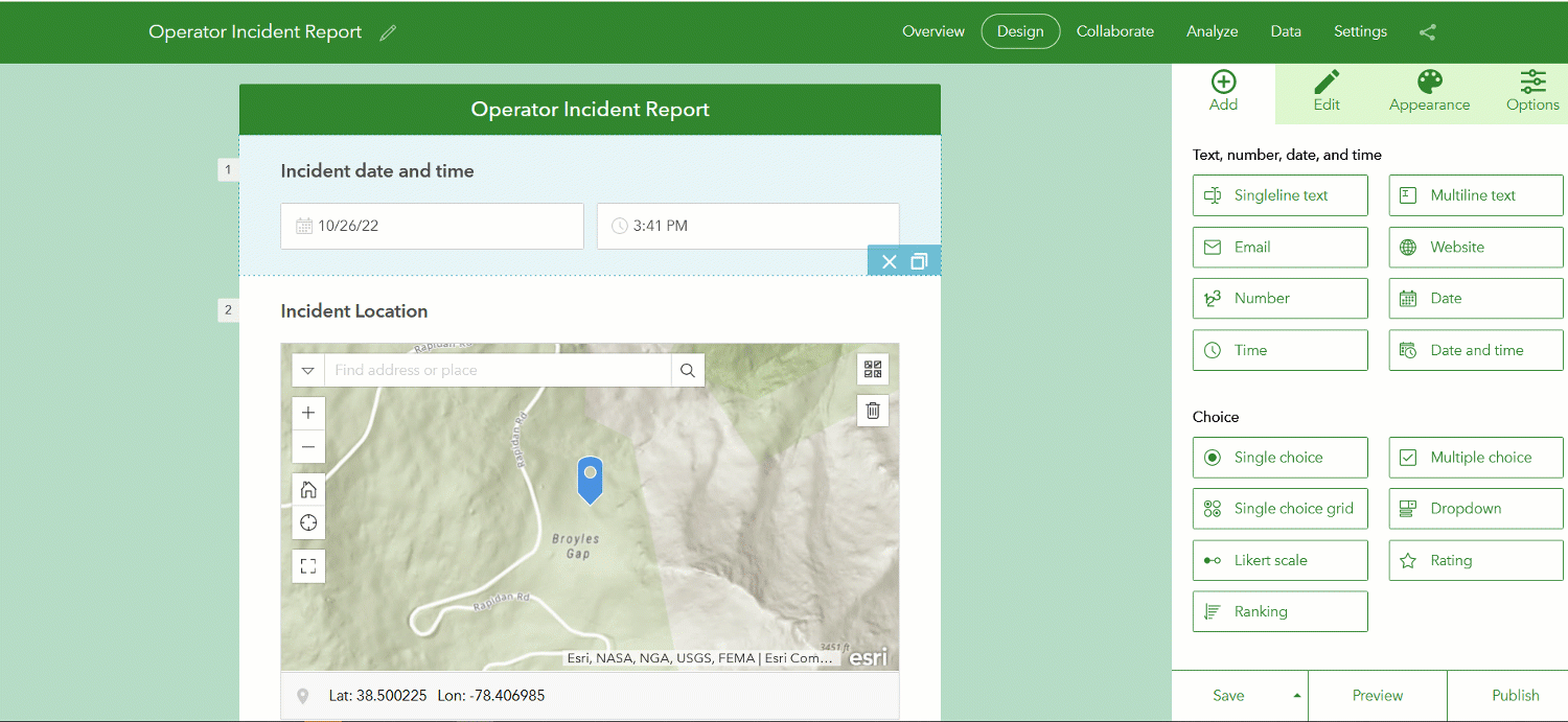

The Survey123 web designer lets you visually build your own forms. Once published, you can securely share them with people within your own ArcGIS organization, or with the general public. Surveys created in the Survey123 web designer can be completed in a browser or in the Survey123 mobile and desktop apps.

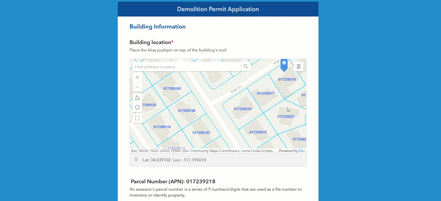

Calculations have been available for a while in the Survey123 web designer. With this release, you can now configure geo-calculations. This will help you make your forms geographically smarter! Below is an example where a geo-calculation automatically gets the APN (Assessor Parcel Number) of a parcel, when the respondent clicks on it.
To retrieve the APN, the form uses the location from the map to do a point-in-polygon query against the parcels layer. Parcels are just one example. You can configure point-in-polygon queries to hit any polygon layer you may already have in ArcGIS. You also decide the value from the intersecting polygon that you want as an output for your calculation.

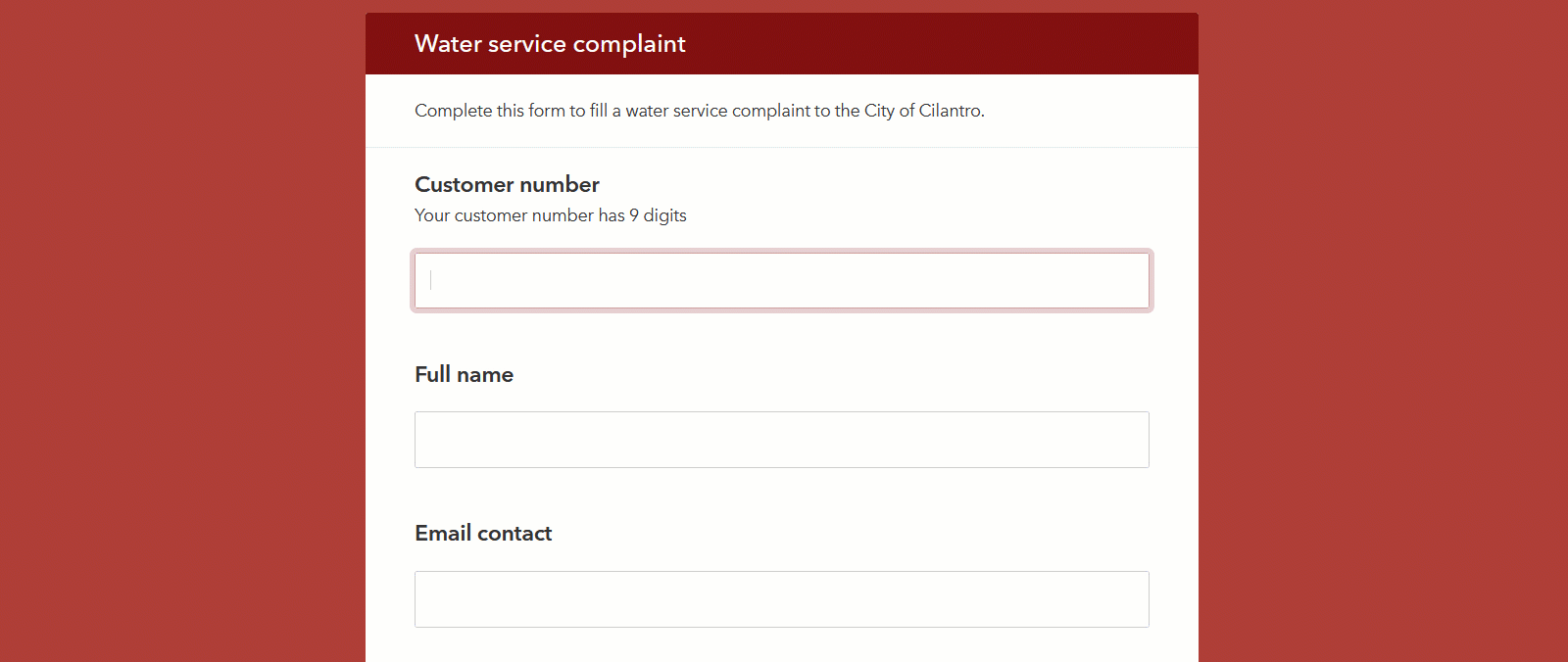

As you play with this new option, you will soon discover that you can do attribute queries in your calculations too. This is useful when you want to simply take a value and do a lookup search on a table or layer to bring some additional data into your form. Below is an example where I take a customer number and automatically retrieve the full name and email contact of the customer. That's all done through a simple attribute query calculation.
