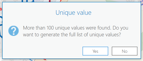

Yet, coloring the many thousand subnet lines (coloring by subnetwork name, what else can I do)) we get this warning:
Well, I have to click Yes to have some sort of useful coloring.

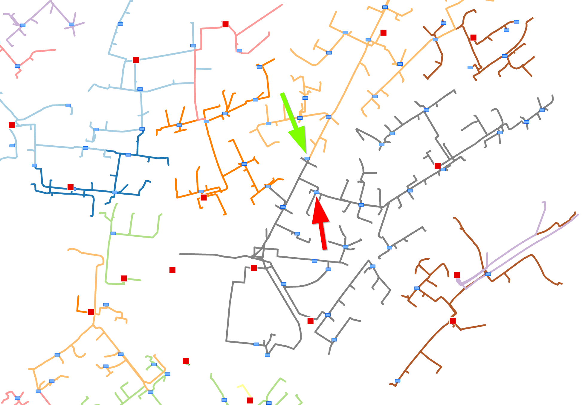

Besides likely not being nice to performance having coloring based on a very large number of unique values, we also quickly see the problem: Adjacent subnetworks (subnet lines) are assigned colors very alike (or perhaps the same).
In the screen dump below, the green arrow indicates a place where adjacent subnetworks are assigned contrasting colors whereas at the red arrow two adjacent subnetworks are assigned the same color:
My propsal to Esri is, that when updating subnetworks, you also assign a coloring-number to each subnetwork (an extra attribute to be added). Not a color code (#3380ff) - just a number from 1 and up. Then I may choose whether 1 is represented by red, green, ...
In a previous proof of concept, I showed that the entire low voltage grid (real world data for a low voltage grid feeding several hundred thousand customers) could be colored using less than 15 colors (it's years ago - I don't recall the exact number - it was less).
As the utility network is persisted in a graph, without being an expert on these matters I believe such coloring-numbers could be easily generated using the so-called graph edge-coloring:
https://en.wikipedia.org/wiki/Edge_coloring
This way I could symbolize my subnet lines based on not thousands of subnetwork names but based on less than 15 coloring numbers.
And I would be sure that adjacent subnetworks would be assigned contrasting colors; It's quite a lot easier to define 15 contrasting colors than to do the same with thousands...
