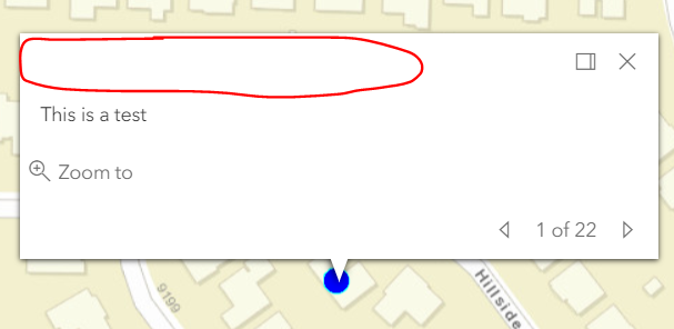

I have been in the process of updating an application from 4.6 to 4.14 and have noticed something weird happening with my popup templates. Whenever I click on a feature, it opens the popup but the title briefly appears before vanishing. It doesn't seem to be related to the features, featureLayer, or renderer as I created test objects of each and it acts the same.
Picture of blank title:
Code for feature:
