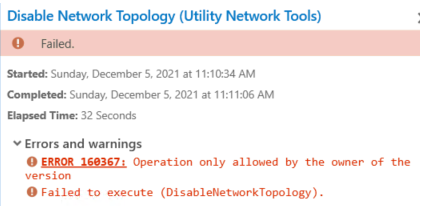

As an example, I was adding a new network rule to my Utility Network and I got this error when running the Disable Network Topology GP tool.
Ultimately, I changed the workflow to include changing Default’s access level to Public before adding the network rule. Here are the steps:
- Stop the Utility Network service
- Kill all database connections
- Change DEFAULT to Public
- Run GP tool
- Change DEFAULT back to Protected
- Start the Utility Network service
