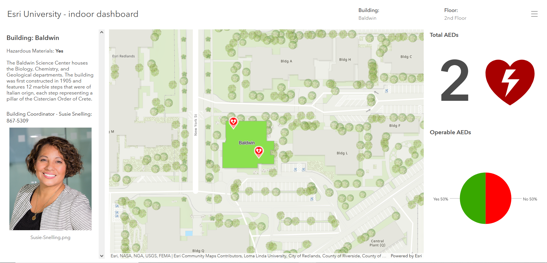

Floor Aware Dashboard
Using ArcGIS Dashboard, you can take the standard schema and layers and create a powerful and flexible, interior space viewer.
The only ‘trick’ to employ, is some of the nested filtering that is possible with ArcGIS Dashboards.
The dashboard below uses the selectors found as part of the Header widget, to allow filtering across buildings, floors, and assets.
After adding a Header, you then have the ability to add 'Category Selectors', which can be configured to provide cascading filters for your features.
So - after selecting 'Baldwin' as the building, the floors selector shows only the floors that are found in that building. Then, after selecting '2nd Floor', I am filtering for only those AED's that are on the 2nd Floor of Baldwin Science.
This dashboard is obviously quite basic. Yet, the same filtering logic could be applied to multiple assets, CAD floor plans, rooms, etc., to create a robust indoor asset viewer/finder.

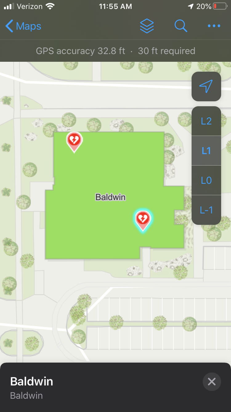

Field Maps - Floor Aware Viewing and Data Collection
Out of the box - ArcGIS Field Maps has floor awareness (as long as your schema is right).
If you want to enable searching by facility name, or contact name, those options can be configured in the 'map options'. Also, if you wanted to have the ability to capture 'floor aware' asset information, this is where creating domains for both the building and floor attributes is crucial.
