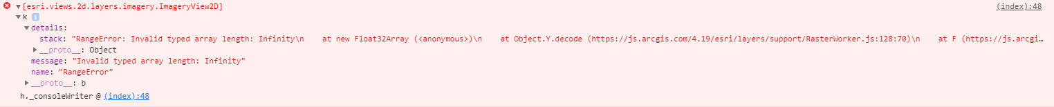

I am exploring the use of lerc and client side handling of pixel data. In the specs I see it as capable, however I'm not sure how to configure my layers to get it to work. One is a classified one like landcover (just doesn't show), the other based on floating point values (gives an infinity error).
Is this a bug, our service, or user error on configuring the layer? ArcGIS server 10.41 (should be supported as of 10.3)
codepen: https://codepen.io/lizeidsness/pen/gOmLovj
