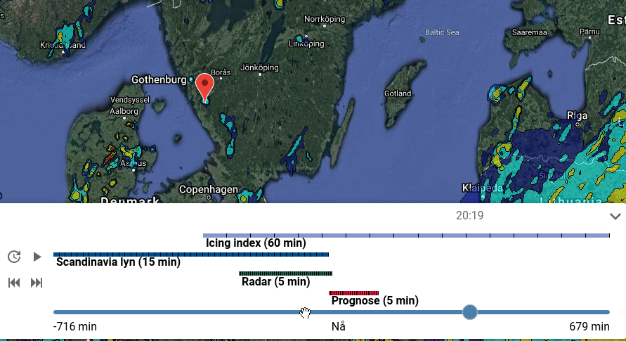

Our application utilizes multiple meteorological layers from multiple WMS-servers. The layers have different TimeDimensions (both start/end and intervals) and user is able to mix and match these as he deems fit. The user is also thereafter able to replay the data via a TimeSlider, and view the Time dimensions for the different layers.
The above is what we are trying to replicate in ArcGIS. It shows the data from 4 layers from three different servers. The layers all have different start/end times (visualized by the colored bars) and different intervals (the number inside the parentheses and the vertical lines across the colored bars)
