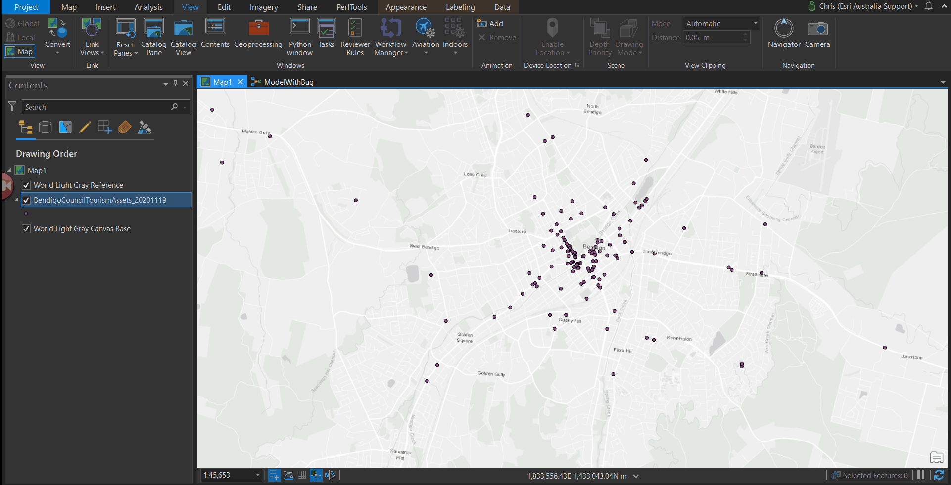

- Go to ‘Project’ -> ‘Options’ -> ‘Device location’
- Select the COM device from the dropdown list, setting the accuracy threshold, if you need.
- In a project, select the 'View' tab, then press 'Enable Location.'

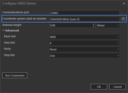

If you are creating new features, the geographic coordinate system on the feature class that you are editing must match the geographic coordinate system selected in the device properties. To change the device coordinate system, go to ‘Project Options’ -> ‘ Device Location’ -> ‘Properties’.
This setting should also match the coordinate system on the GNSS receiver if you require accurate locations. For example, if you are configuring a Trimble R10 to provide locations, you should set GDA2020 on the Trimble, in the ArcGIS Pro settings, and in the point feature class coordinate system.
The properties window also allows for an antenna height to be specified. This is the distance from the antenna to the ground. If using your phone or computers’ onboard GNSS, this can be measured and added into the settings. If you are connecting to an external receiver, it is important to know whether the antenna height is pre-corrected into the NMEA position. Most GNSS receiver manufacturers, by default will stream elevations to NMEA based on the phase centre of the antenna, but some others will allow for the configuration of antenna heights and offsets, which are incorporated into the position to provide ground elevations. It’s good practice to check your receiver documentation, or test on a known benchmark to confirm.
