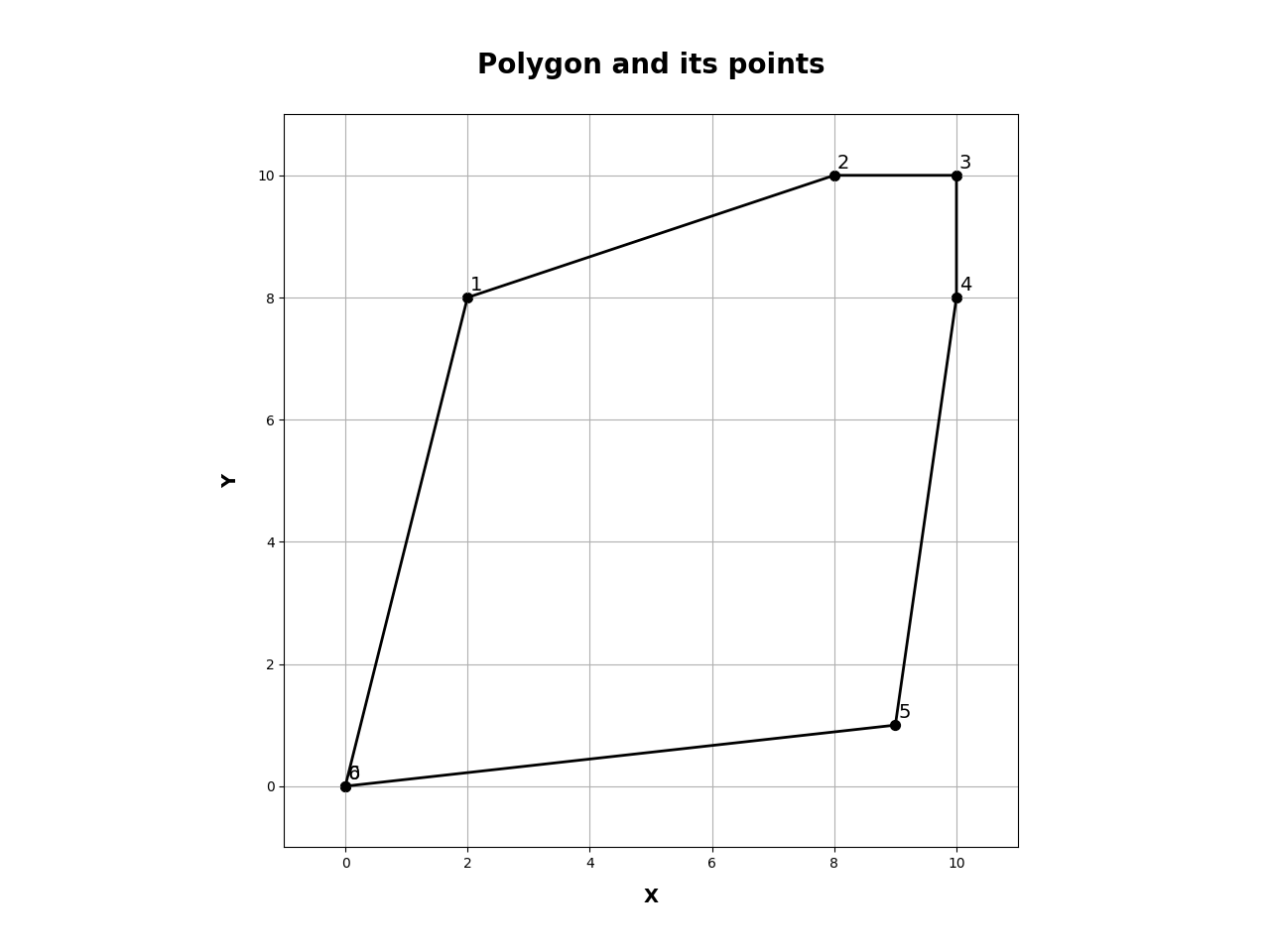

Here is what a simple polygon looks like represented like an array (even an arcpy.Array )
a # ---- an array of x, y coordinates... first and last are the same
array([[ 0.00, 0.00],
[ 2.00, 8.00],
[ 8.00, 10.00],
[ 10.00, 10.00],
[ 10.00, 8.00],
[ 9.00, 1.00],
[ 0.00, 0.00]])
dxdy # ---- sequential, delta x and delta y between the pairs
array([[ 2.00, 8.00],
[ 6.00, 2.00],
[ 2.00, 0.00],
[ 0.00, -2.00],
[ -1.00, -7.00],
[ -9.00, -1.00]])
leng # ---- the inter-point pair distance
array([ 8.25, 6.32, 2.00, 2.00, 7.07, 9.06])

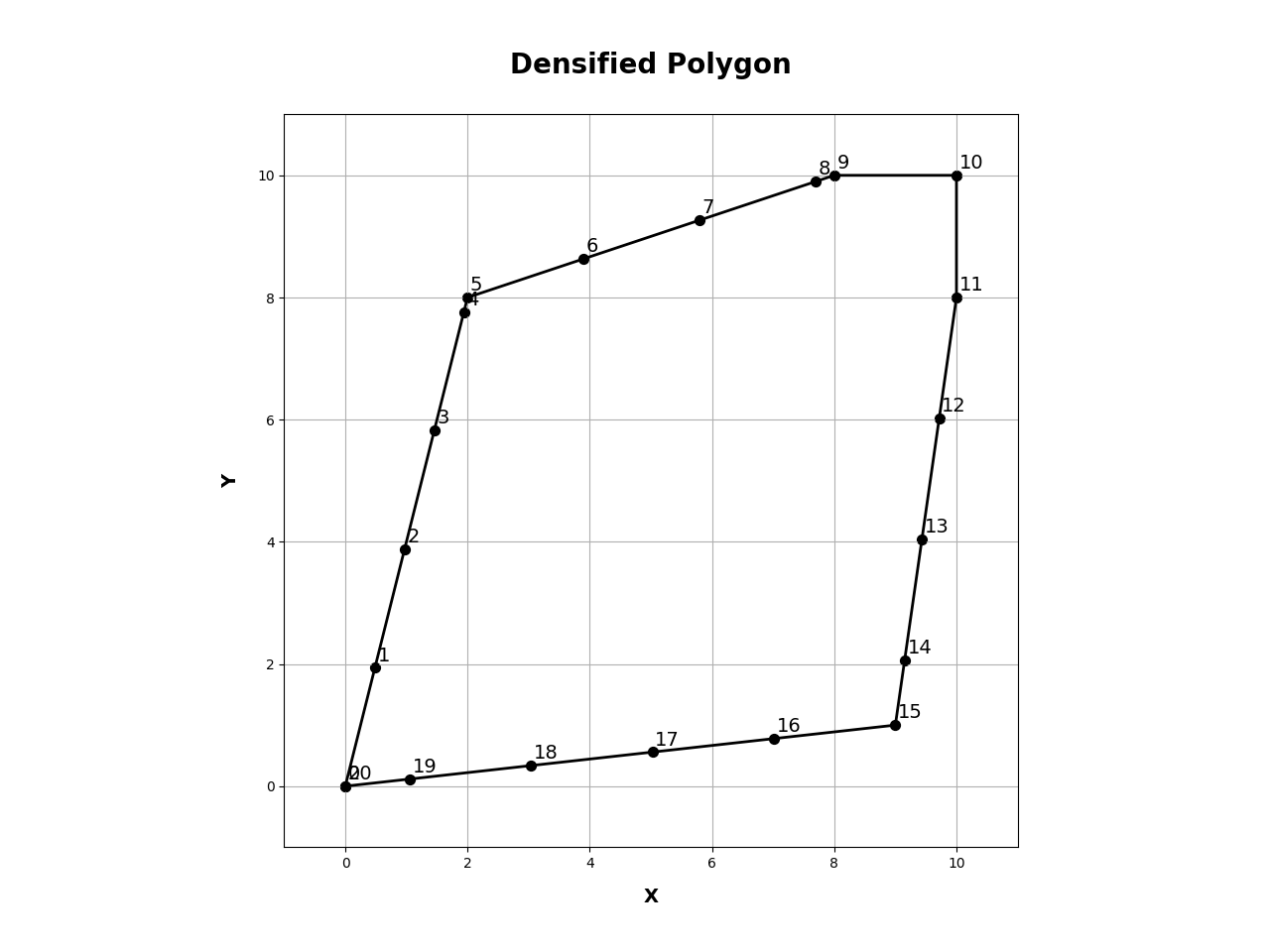

Now that the magic is done, the rest is just stuff to determine whether you want to densify based on an absolute distance or as a percentage of the total distance.
The for loop section can be simplified, however, I kept it as such since it shows how each segment gets densified and the results collected and then assembled into the final result,
So what does it look like? The simple polygon shown above and the densified version are as follows.
Plots done in Spyder using Matplotlib.
