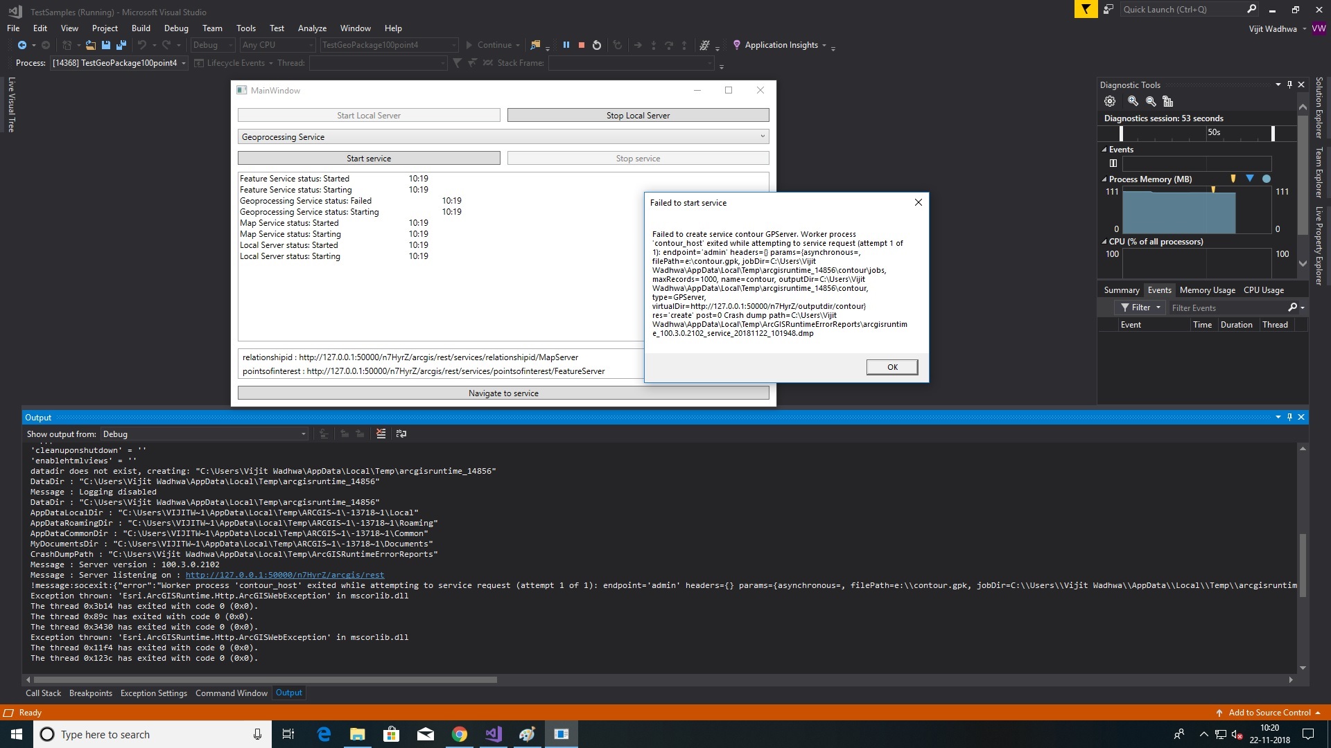

Hi , I created a .gpk file from ArcMap to use it in runtime. But after starting the local server , as soon as I start the LocalGeoprocessingService, I get an exception as follows
!message:socexit:{"error":"Worker process 'contour_host' exited while attempting to service request (attempt 1 of 1): endpoint='admin' headers={} params={asynchronous=, filePath=e:\\dlrl for kolkata 2\\feature to json\\contour.gpk, jobDir=C:\\Users\\Vijit Wadhwa\\AppData\\Local\\Temp\\arcgisruntime_3828\\contour\\jobs, maxRecords=1000, name=contour, outputDir=C:\\Users\\Vijit Wadhwa\\AppData\\Local\\Temp\\arcgisruntime_3828\\contour, type=GPServer, virtualDir=http://127.0.0.1:50000/q3HDdY/outputdir/contour} res='create' post=0 Crash dump path=C:\\Users\\Vijit Wadhwa\\AppData\\Local\\Temp\\ArcGISRuntimeErrorReports\\arcgisruntime_100.3.0.2102_service_20181024_110823.dmp","name":"contour","processId":-1}
Exception thrown: 'Esri.ArcGISRuntime.Http.ArcGISWebException' in mscorlib.dll
at Esri.ArcGISRuntime.LocalServices.LocalService.<StartServiceInternal>d__25.MoveNext()
--- End of stack trace from previous location where exception was thrown ---
at System.Runtime.CompilerServices.TaskAwaiter.ThrowForNonSuccess(Task task)
at System.Runtime.CompilerServices.TaskAwaiter.HandleNonSuccessAndDebuggerNotification(Task task)
at System.Runtime.CompilerServices.TaskAwaiter.GetResult()
at Geoprocessing.MainWindow.<ServerStatusChanged>d__3.MoveNext()
Can anyone please tell me, what I am doing wrong ?? and how should I resolve this issue ?

VijitWadhwa
Hi,
Mike I am simply trying to run one of the given samples
Local Server Services—ArcGIS Runtime SDK for .NET Samples | ArcGIS for Developers without making any changes in deployment file,
The Map Service and Feature Service start successfully , the problem comes only in geopackage (for starting geoprocessing service). This geoprocessing service is starts successfully when I run this sample in java, but in .NET , I am facing this issue from a long time and I am unable to resolve. I also tried making changes in deployment file , by changing the geoprocessing tags to true . But , the problem still persists. This is how the error appears
Please Help me resolving this , I am stuck in my development process because of this issue.
Thanks
MichaelBranscomb
Esri Frequent Contributor
Hi,
If you're running the Contour tool, you will need to enable 3D Analyst or Spatial Analyst in your deployment configuration:
e.g.
<Package id="ArcMap3DAnalyst" name="3D Analyst" enabled="true" />
or
<Package id="ArcMapSpatialAnalyst" name="Spatial Analyst" enabled="true" />
Also, depending on what data types are used in the geoprocessing package you may need to enable some additional dataformats
e.g. I have enabled raster data support and vectoe data support below.
<Package id="ArcMapAdditionalDataFormats" name="Additional Data Formats" enabled="true">
<ChildPackages>
<!--Provides additional raster file data format support.-->
<Package id="ArcMapRaster" name="Raster" enabled="true">
<ChildPackages>
<!--Provides support for ECW format Raster.-->
<Package id="ArcMapECWRasters" name="ECW Rasters" enabled="false" />
<!--Provides support for Raster Mosaic Layers.-->
<Package id="ArcMapMosaicRasters" name="Mosaic Rasters" enabled="false" />
</ChildPackages>
</Package>
<!--Provides additional vector file data format support.-->
<Package id="ArcMapVector" name="Vector" enabled="true" />
Cheers
Mike
