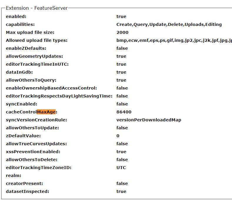

I set cacheControlMaxAge to 24 hours on ArcGIS Admin but when I see the response header still the max-age is 0. I appreciate if anyone can help.

this is how my service looks like regarding cacheControlMaxAge
