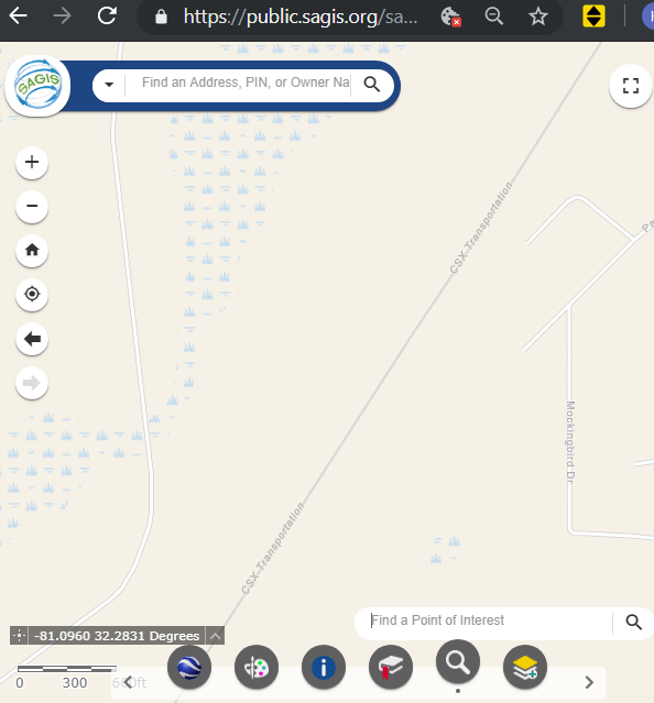

One question still..  I want to disable Suggest on the Esri locator. Is that possible?  I want to have it there in my Search widget in the upper-left on my WAB viewers as an option, but don't want it to pollute the Suggest auto-complete list, with less-accurate results for street addresses. In other words it will be an option, but tucked away neatly. For now, my approach is to isolate the Esri geocoder to its own widget. Example:
I do hope Locators' REST will support URL parameters in the future. This would significantly expand their ability to integrate with other applications. URL parameters make it so easy to integrate when coming in from another product or site; or embed in another site.  Because they can be so easily changed programatically for whatever reason.
