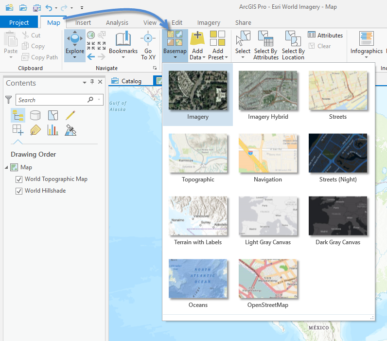

On the Map tab click the Basemap Gallery button and choose the Imagery basemap.

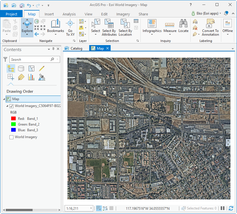

The Map Tile Package layer will be added to the map when the export completes. (remove the space in the layer name.. see notes below)

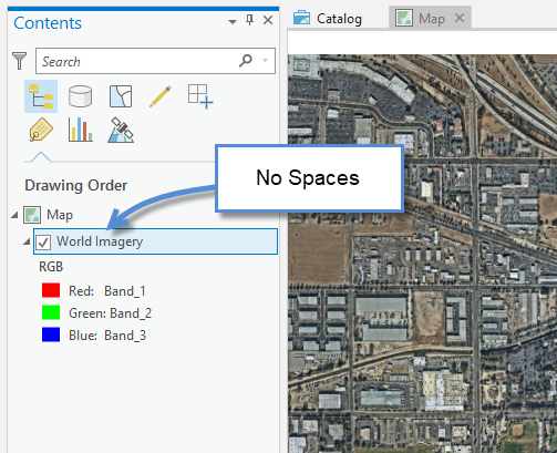

Do not use spaces in the name of the Tile Package layer in the Contents pane. It is OK to rename the layer, but do not use spaces in the name. Tile Package are not written into the package correctly when spaces are used in the name, this issue will be addressed at a future release.

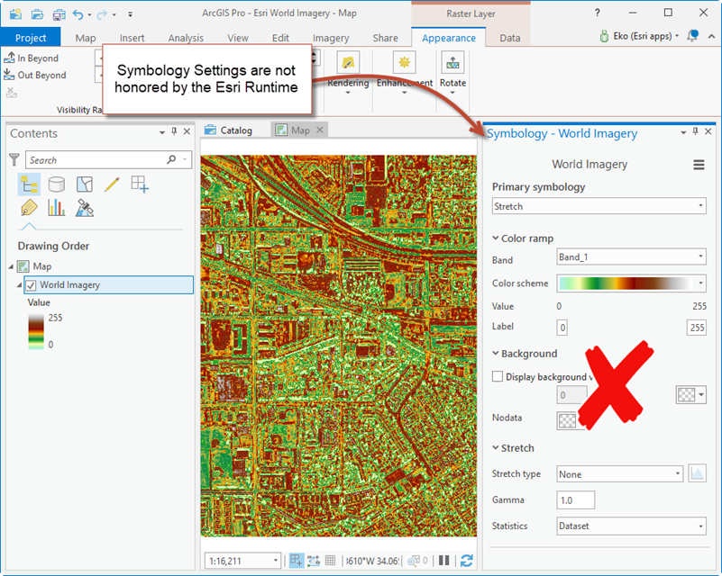

ArcGIS Pro allows you to apply symbology to Tile Package layers. Symbology parameters are not supported by the Esri Runtime. You will just see the TPK as it was originally created in the runtime applications. You can think of the symbology settings in ArcGIS Pro as over-rides for the symbology defined in the TPK.
