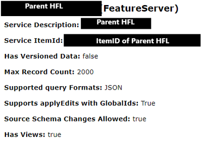

Feature Layer
This is where I get confused! This "feature layer" is tied to the parent HFL. So when the parent gets updated, this feature layer also gets updated. However I have no idea how this was created.
It just shows up as a "feature layer"
All that is found on the details pane is the following:
The only way I can tell that it's connected to the parent HFL (apart from seeing the updates) is checking the REST services directory for the item and seeing that it refers to the parent HFL.
This isn't causing any functionality issues, but it just bothers me that I have no idea how it was created!

I was going to say these sound like they are Esri View Layers, but if they were a view layer, it would have this:
What it sounds like is that the parent layer "Food" was configured, perhaps with a filter or symbology, and then saved as a new layer, "Fruit" and then again and saved as a new layer called "Veggie".  You can do this configuration and saving of the parent layer's (in your case "Food") Visualization tab, or in a web map. We do this all the time- it is a little like how you might use .lyr file in desktop, right? You might need to show the data one way for one map and another way for another map.
With the Esri View (mentioned at the top), you can take things a step further and control who can see what 'view' of the data or who can edit it etc. not just the symbology or filtering...
