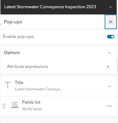

I have joined a hosted feature layer and a hosted table to make a Latest Inspection layer using the Join Feature in ArcOnline Map Viewer Classic. When I insert the layer into Map Viewer, select a feature, the popup does not work. If I go to Map Viewer Classic, the popup works just fine. Is there a capability issue with these types of layers in Map Viewer?
The popups use to work as there are whole dashboards created in my organization dedicated to the information that the table provided. I am in the process of updating them and I am unsure why I am getting this error now.

Yes. That is what I meant. The pop-up is configured to the layer default. The only time that the pop-up will even render in Map Viewer is when I am in the configuring pop-up tab and it shows the example. I have attached what it looks like below. I have tried removing all but one field to see if it was the amount of fields that made it take forever to load and then time out but I am still receiving the same issue.

What if you changed it from a fields list to a text or Arcade item? Does anything change?

Unfortunately, no. I still get the loading circle and then it times out.
The pop-ups load immediately in Map Viewer Classic. I made an App with WebAppBuilder as an experiment and the pop-up works which I assume is because WebAppBuilder utilizes Map Viewer Classic. The end result on where I want to use this is in Dashboard and Experience Builder. Both use Map Viewer.
