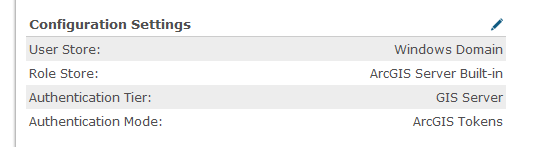

Is the ArcGIS Server service secure?  Also, what type of authentication are you using for your ArcGIS Server security?
I noticed that if you have web tier authentication and the service is not secured, you will still have to specify a username/password.
Ex of web tier authentication:

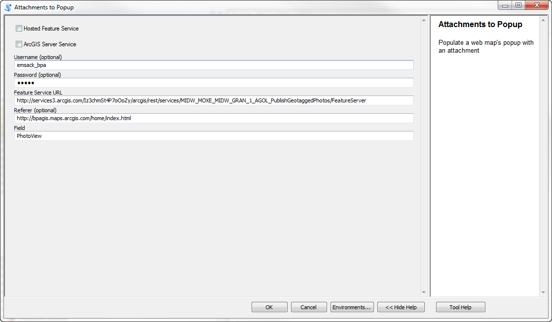

Hey Jake - any chance I can send you an invite to take a look at service in AGOL I am having trouble getting this tool to run on?  I'm getting stuck at line 41.
Hi Eric,
Sure, my username is jskinner_CountySandbox.  Also, please make sure 'Sync' is enabled on the service.
All set Jake; invite sent- sync was already enabled.
Thanks in advance for your time- the feature service I am trying is called 'Geotagged Photos for Midway-Moxee No 1 and Midway-Grandview No 1 2016' :
http://services3.arcgis.com/Iz3chmSt4P7oOoZy/arcgis/rest/services/MIDW_MOXE_MIDW_GRAN_1_AGOL_PublishGeotaggedPhotos/FeatureServer
The field is called ‘GeoTaggedPhoto’.
Eric Sack/GISP
ACS
Geographer III | Civil Design – TELF
Bonneville Power Administration
bpa.gov<http://www.bpa.gov/> | P 360-619-6359 | C 503-957-6734
One other question, what is the referer to your ArcGIS Online Organization?
I wasn’t sure what that was – is it our Organizational URL?
http://bpagis.maps.arcgis.com/home/index.html
Eric-
Eric,
It doesn't look like the GeoTaggedPhoto field length is large enough.  I downloaded the service using the following tool, changed the field length to 700, and then re-uploaded to ArcGIS Online.  I was then able to successfully run the Attachments to Popup tool.
Ah – thanks Jake; I created a new one called PhotoView with 700 field length but still get this error and how I have the tool populated.
Eric-
Hi Eric,
I see a few errors in how the tool is set up:
1.  You will want to check 'Hosted Feature Service' since you are updating a hosted feature service
2.  The Feature Service URL should reference the index (i.e add /0 at the end of the URL) of the layer you are updating.  Ex:
http://services3.arcgis.com/Iz3chmSt4P7oOoZy/arcgis/rest/services/MIDW_MOXE_MIDW_GRAN_1_AGOL_Publish...
Notice the '/0' at the end of the URL.
3.  The referrer should just be the following (I need to update the help on this):
I went ahead and ran the tool:
I also created a web map:
https://www.arcgis.com/home/webmap/viewer.html?webmap=97ea751bf416486eab413a2d0def8e0d&amp;extent=-1...
If you click on a feature you will see the image directly in the popup.
Jake - thanks again for your time; it works great!  I was able to configure the pop-up in my web map and am all set.
Best regards-
Eric-

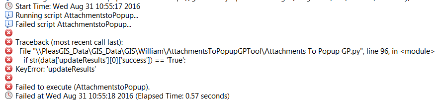

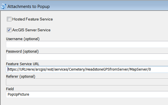

Hi Jake,
New to python...
Should I have changed the script on line 96?
Attached is my setup and updateResults error.
Script Setup
updateResultsError
Hi William,
You will need to change your URL.  You are currently referencing the Map Service.  You will want to reference the Feature Service.  i.e.:
https://URHHere/arcgis/rest/services/Cemetery/HeadstoneGPSfromServer/FeatureServer/0
Jake - Thank you!!! For both the script and quick respond. It worked
