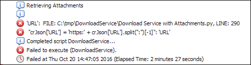

Neat tool! I'm able to get the features, but am having issues with the attachments. See error below.
mimiller‌,
Can you share the service to a Group and invite my ArcGIS Online account to this group?  My username is jskinner_CountySandbox.  I can test downloading the service with attachments.

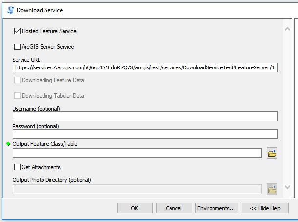

Hi Jake,
Thanks so much for testing.
I download the Service to C:\Test , extract the zip file and from inside ArcMap v 10.4.1 run the script from this shared folder.
When I start your Download Service toolbox it looks like this.
However as soon as I tick "Hosted Service layer" the "Download Feature Data" and "Download Tabular Data" grays out. I am then unable to tick the box.
I have found that if I tick the "Download tabular data"  first (before anything else) I can tick it but then as soon as I tick "Hosted Feature Service" it grays out again.
Possible a version issue in ArcMap? Or me being stupid?
Hope thsi helps and you can see the issue. Really need to get his working after spending so much time setting up a  related tables solution. Will massively appreciate your help.

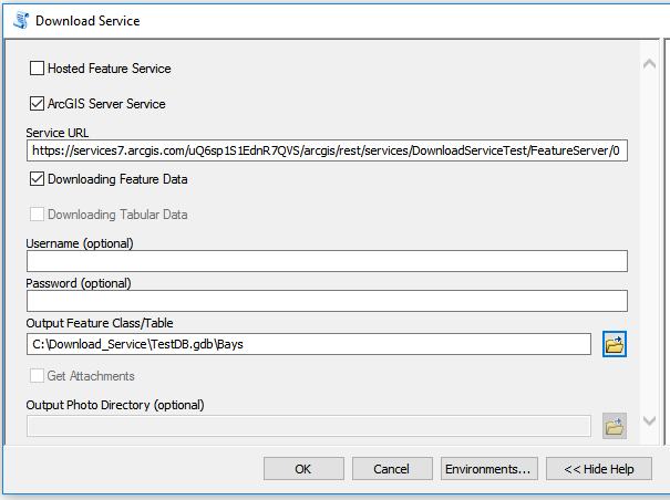

Hi Jake,
This should blow your mind.
Messing around I tried using the "ArcGIS Server Service" even though it is hosted on AGOL. I get none of the greying out issues as post above, and it seems to work perfectly! I get the Customer data out fine.
If I then try and download ...FeatureServer/0 using "ArcGIS Server Service" and selecting "Downloading Feature Data" it also seems to works fine!
I checked again downloading ...FeatureServer/0 using "ArcGIS Feature Service" and it also works fine!
Too much for my little mind!
Graham Misselhorn‌, if you downloaded the latest version of the tool, you should have the option to check 'Downloading Feature/Tabular Data' when 'Hosted Feature Service' is checked:

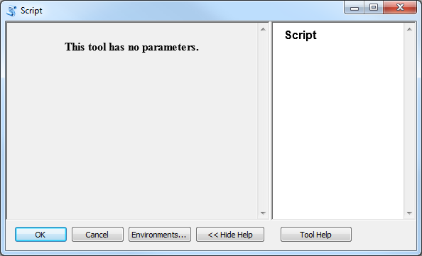

Hi,
Seem to be a great tool, but unfortunately, it doesn't work for me with Arcgis Pro 1.3
here is the message error i get even with my FL or a public FL
Any ideas?
Thank you
Michael Miller‌,
I believe I found the issue.  The OBJECTID field in AGOL is OBJECTID_1.  When you download the feature service to a feature class, the OBJECTID_1 field is converted to OBJECTID.  This was causing the script to fail.  Open the script in a text editor and you can the following line before line 329:
OID = "OBJECTID"
Ex:
lodecombe_DirEtudes‌,
Unfortunately, this tool will not work in ArcGIS Pro.  Pro uses Python 3.4, while ArcGIS Desktop uses Python 2.7.  This tool was written using Python 2.7.
