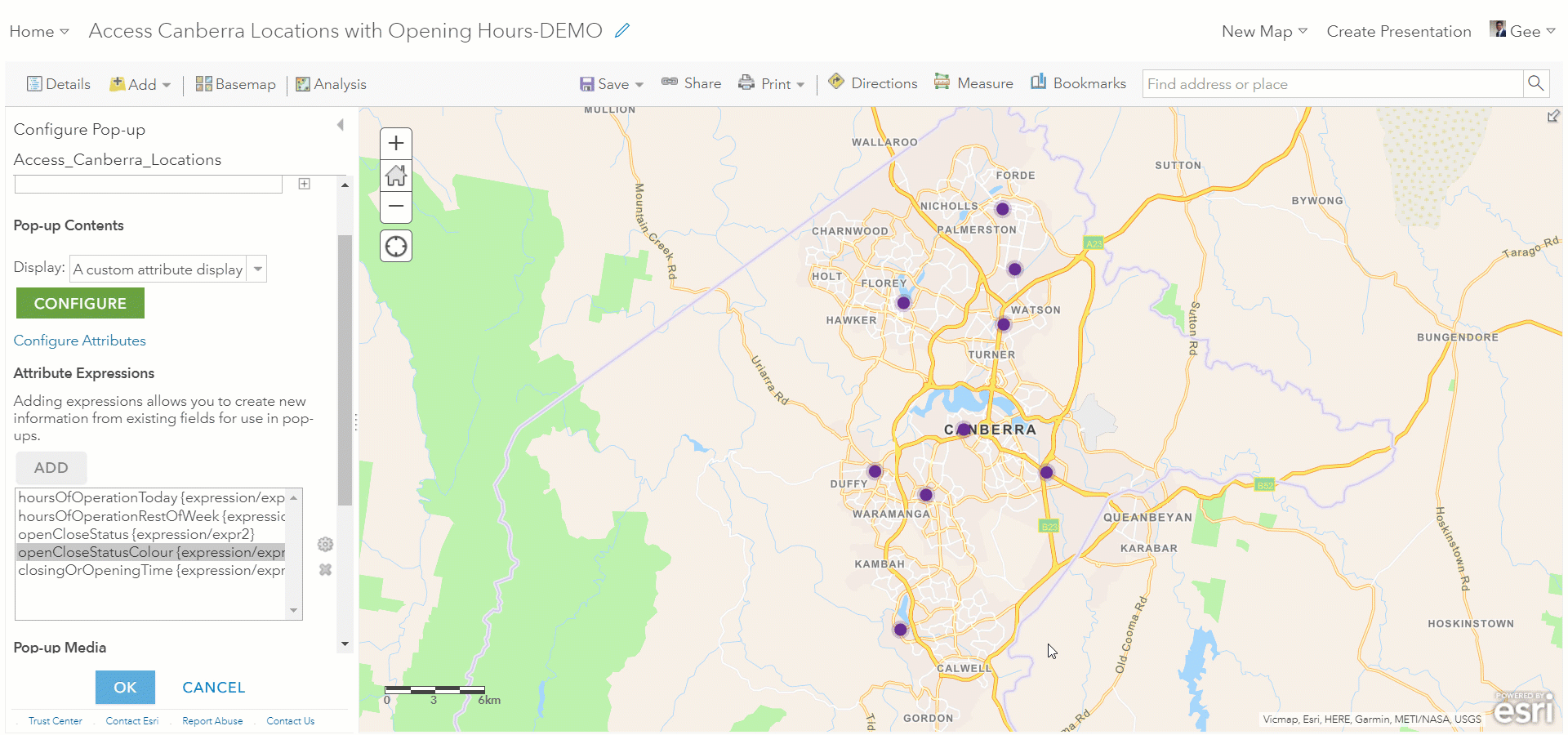

First, find or create a data-set with opening hours (preferably for all days of the week). For this example I’ll be using Access Canberra locations (sourced from - dataACT). Please ensure opening hours are saved as numbers or text field types.
Time Types
Build expressions
Within the pop-up configuration window - build the following expressions or feel free to follow along with this web map.
Opening Hour Expressions
hoursOfOperationToday {expression/expr0}
This expression will return the current weekday alongside its opening hours.

openCloseStatus {expression/expr2}
This expression will return whether the shopfront is Open, Closed, Opens soon or Closing soon based on opening hours and the time displayed on users' device .

openCloseStatusColour {expression/expr3}
If you'd like to re-iterate the openCloseStatus values with added colour - rewrite and replace previous expression's return values with hexadecimal colour values.
