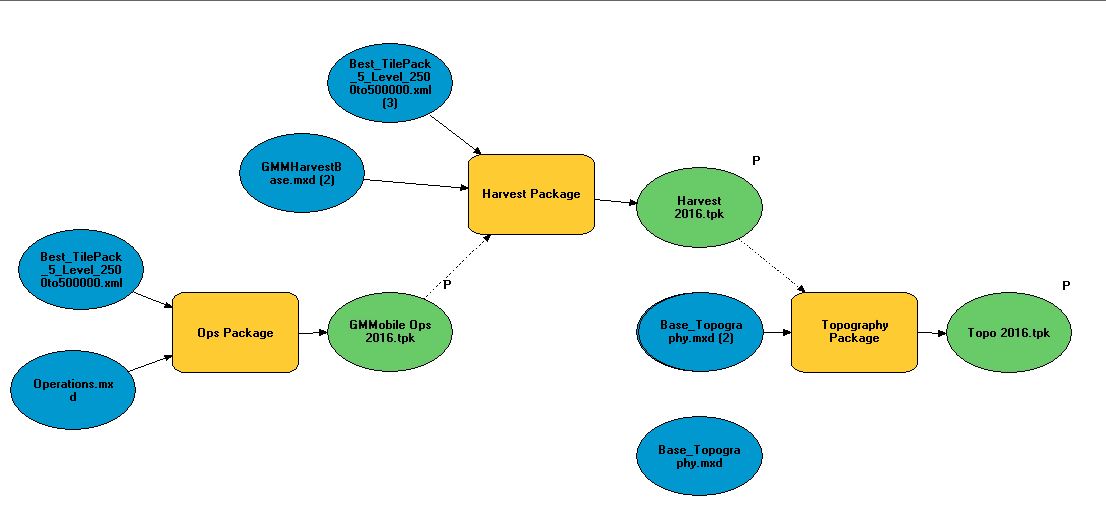

I seem to have a limit in that any Model builder scripted Tile Pack Creation toolbox tool limits the number of package creation tasks to the single first Tile package, i.e if you string three tile creation packages using different mxds, and the same tile scheme for a run time tpk, the tiling is only successful on the one tile package. the others  either are limited in the amount of data included or and often have no discernible data in the package.
Running in Batch mode is a little better but still is incomplete, I tried hanging three packages together using different mxds and different outputs but the same xml tile schema, this didn't work. with the output of the first as a precondition before the next package creation step was started.Modelbuilder script of 3 packages
I also tried running three separate tools simultaneously, with the belief that the software was smart enough to use one of the 8 processor cores that are not busy
That met with the same limitations, ie says it finishes, which it does do (supposedly without error) but still incomplete data in each package. (the 2nd and third are always less than about 1 MB) versus 1.5 GB that I am expecting to see, and when loaded onto a device have no or limited amounts of data present.
