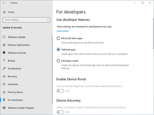

By default, Windows 10 only allows you to install applications from the Microsoft Store.  To install from other sources, you need to enable sideloading:
  1. Open Settings.
  2. Click Update & Security > For developers.
  3. Under Use developer features, select Sideload apps.
