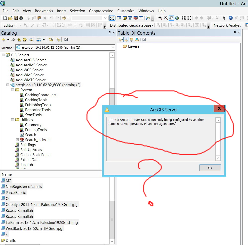

ERROR: “ArcGIS Server Site is currently being configured by another administrative operation. Please try again later.”
I got the error shown in the screenshot below
What might be the issue here?
Thank you
