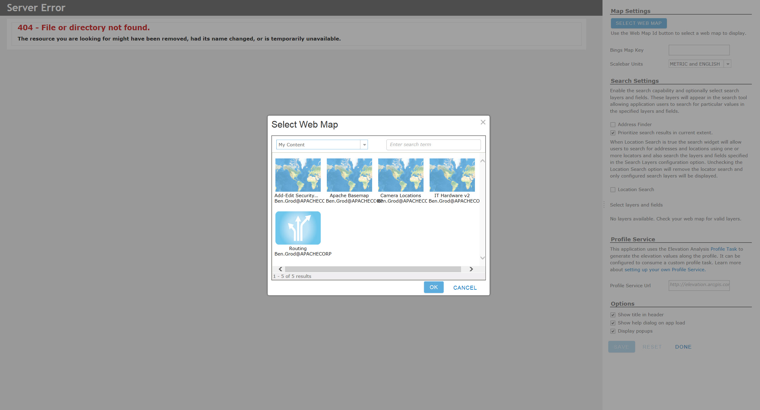

When you install Portal for ArcGIS (10.3) should the complete set of configurable app templates be installed and accessible out of the box or does is require some configuration or additional installs? When I try to create a web app using a template I can see thumbnails and descriptions of all of the templates but when I choose a template I receive the below error. It seems like I may have missed something in the original install?
Configurable Web App Templates appear to be available
Once selected the contents is inaccessible "404 - File or directory not found. The resource you are looking for might have been removed, had its name changed, or is temporarily unavailable"

I know this error - it appears only when you reach the templates screen through "my content".
It will work fine if you reach the templates screen through the map screen - Save a webmap, push the share button, choose to share it as an application and then you'll see the templates screen again and it will work fine.
I really hope ESRI found the solution already and planning on releasing a patch soon.. You don't need to be an expert to see that the URL of the webmap used inside a template is wrong when running it through "my content". They just forgot the "app" path in the URL. you can see it when using Fiddler.

Thanks Sviva, that works.    I can't believe I never approached it that way.  Thank you!
