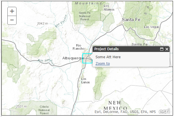

BobbySells
New Contributor II
yes.  I have a whole gdb schema that users load data into.  if they don't have any data load into a particular field they just leave it blank, but some of the features have 40 fields and 10 will be empty.  it doesn't show well in web apps when in the attribute table or popup there are all of these fields with no values in them.  thank you everyone that is helping.
