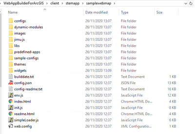

1. Where I have to copy the ZIP file that I have downloaded ? Maybe in a directory here ".\arcgis-web-appbuilder-2.13\WebAppBuilderForArcGIS\client\stemapp" ?
2. Does the directory where I unzip the ZIP file have a specific name?

I have donwload my WebAppBuilder Webmap in a folder called 'samplewebmap', which has this content:
So, I have started node.js service in my WAB for developers.

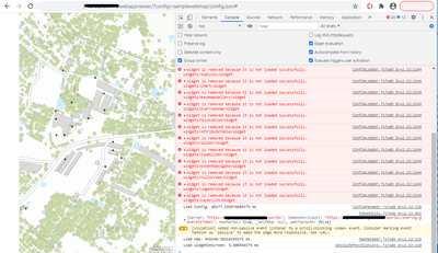

And I have called this URL,  https://localhost:3344/webappviewer/?config=samplewebmap/config.json# but the webmap doesn't open. After a while I have to enter Portal credentials but none of the widgets appears in the Webmap that only shows the basemap and some sample data.
I am able to call http://localhost:3344/webappviewer/?config=sample-configs/config-demo.json# to work with custom widgets that I have modified (only widgets), But I am not able to work with WAB app ...
What I am doing wrong ?
