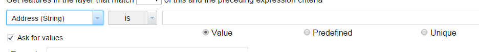

I have a decent start on the configs for my widget. Is there a way to make the drop menu load faster when I choose "UNIQUE"? There are multiple fields that I want unique but it is trying to load over 2 million records.

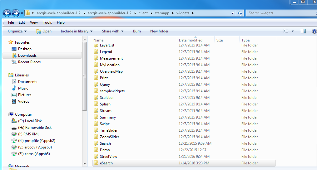

My second question is after I am satisfied with my configs. How do I add that widget to my local widget folder? For some reason when I zip my test map and add it, your configs pop up in web app-builder.

  Querying 2 million record is not practical using web apps. There is no way to speed that up. You should not use Unique in that situation. Use Value or Predefined.
Your second question is confusing. Normally you download a custom widget and add it to the client stemapp folder as you are picturing above. Then you create a new app and add the custom widget to that app using the widgets tab in WAB and then once you have your app completely configured then you download the app from the wab main window and deploy this zipped app to your production web server.
