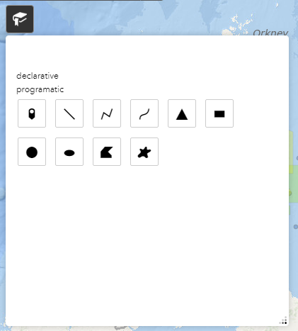

So I have created 2 drawbox in my code now to test this.
One declarative as described above, drawBox and also one created programatic, db2.
The declarative drawBox results in nothing in my widget panel.
And the programatic db2, does appear in my widget panel but is not limited to only the extent button, I get all the geo types even though types is set to ['EXTENT'].
widget panel

Im not sure why setting the first one doesnt appear at all, and I dont know whay the second one shows all types not just extent.
These are the problems I encountered before that led me try creating my own button that calls
this.drawBox.activate('EXTENT')
I've kind of gone full circle! But I would like to get this declarative method to work with only extent available...
Whats causing the first attempt to not show anything at all (drawBox)?
How do I limit it to only show extent in the second method (db2)?

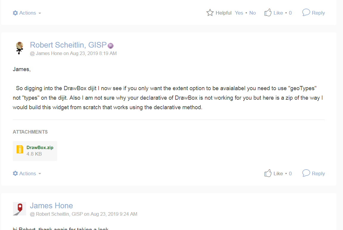

  So digging into the DrawBox dijit I now see if you only want the extent option to be avaialabel you need to use "geoTypes" not "types" on the dijit. Also I am not sure why your declarative of DrawBox is not working for you but here is a zip of the way I would build this widget from scratch that works using the declarative method.

hi Robert, thank again for taking a look.
I have tried types, geoTypes and setting both but I always get all the options not just the extent option.
Im not sure how to access the zip you mentioned, I cant see it.

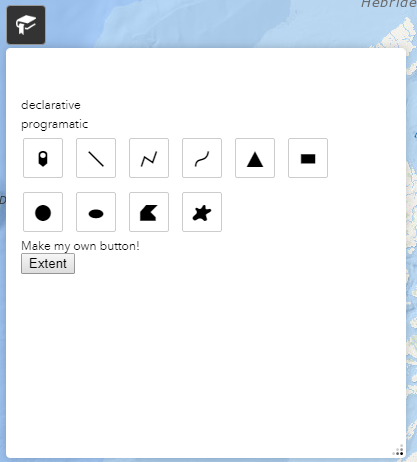

Hi Robert,
I am unable to find the zip in my inbox, I can see a single entry in there for all the replies in this thread but I cant see any attachments or files.
I have used ['EXTENT'] for types and geoTypes but it seems to have no effect.
Heres my code where I have tried 3 methods to get just an extent drawbox thing:

The only one that worked was the 3rd one but I know this isnt the way Im supposed to do it.
Id really like to get the declarative one displaying but have no idea why it isnt...
widget results
Declarative: no display
Programatic : not limited to extent
Button: Works but Im not really using the dijit properly.

Thanks robert, I finally have my declarative method wroking. I was only using types not geoTypes in the HTML, which I completely missed as I was looking in the js for the error.
I still have no idea why the second one doesn't restrict to extent but Im not going to worry about it.
