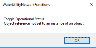

BELHADJMOHAMED
Hi everyone, I use the local government data of ESRI and everything goes well except for the tool named "change operable status of a valve" I got a message please look at the joined file. ThanksValve_Status message
