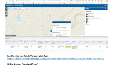

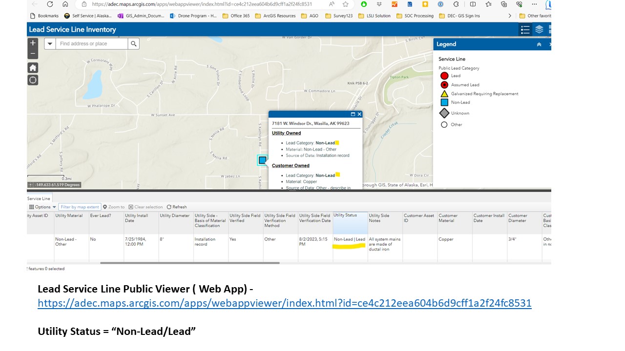

I'm looking at the attributes table of the web application displayed on our Hub site: https://ak-lsli-adec.hub.arcgis.com/
At the bottom of the page is our Lead Service Line Public Viewer - Web Mapping Application. Direct link: https://adec.maps.arcgis.com/apps/webappviewer/index.html?id=ce4c212eea604b6d9cff1a2f24fc8531

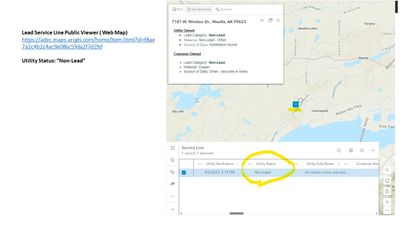

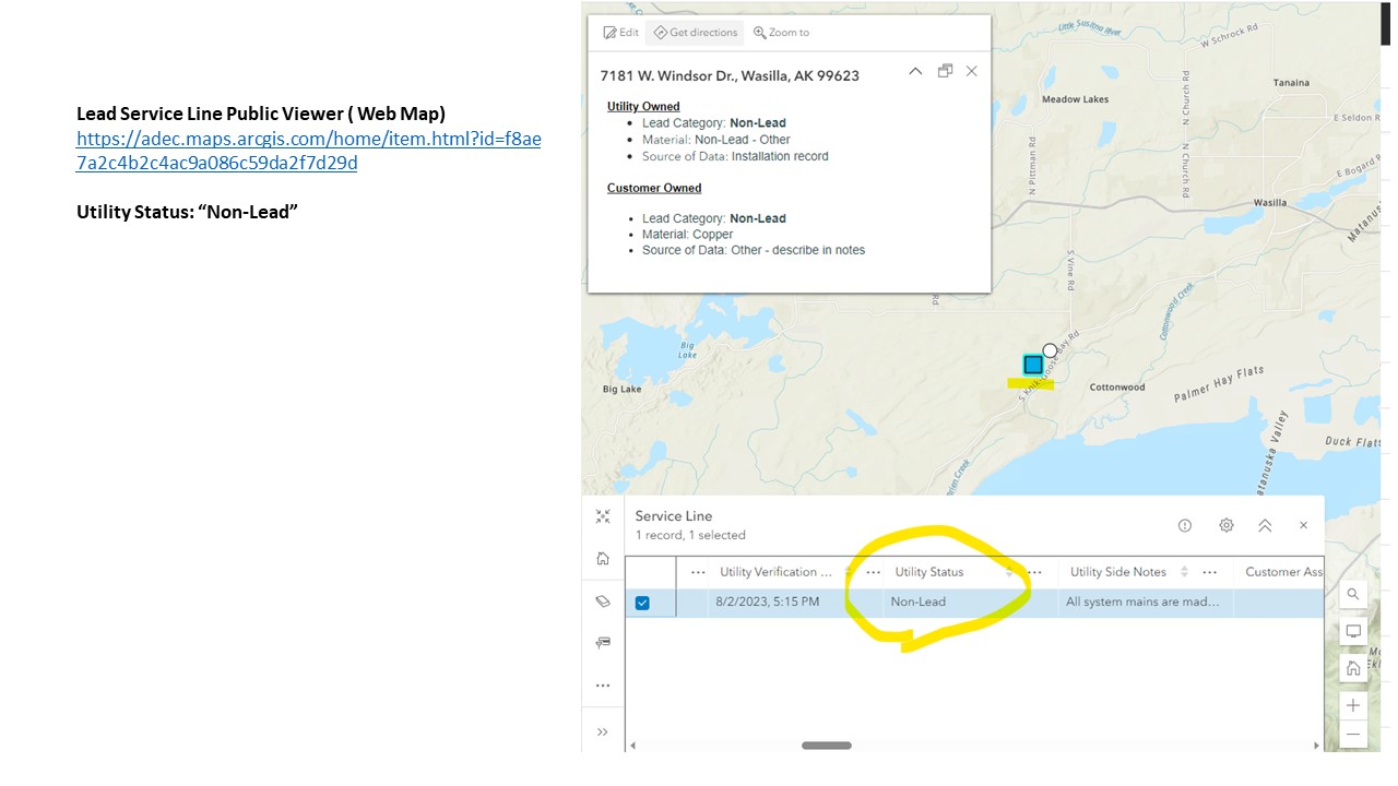

In the attribute table in the application, the Utility Status and Customer Status fields have two entries in one cell: Lead I Non-Lead, Lead I Lead, etc...  They symbology is correct in the map, but the attribute fields are not.
The web map used to create the app: Lead Service Line Public Viewer
https://adec.maps.arcgis.com/home/item.html?id=f8ae7a2c4b2c4ac9a086c59da2f7d29d has the correct information in the attribute (one entry per cell)
I understand there's some sort of expression being used but I'm not sure where this is located. In the screenshots provided, I don't understand why the Utility Status is displaying- Non-Lead I Lead
We've made some modifications to the original solution, so I'm hoping that we didn't mess up and arcade expression behind the scenes. How can I get the Utility Status and Customer Status fields to display what is entered in the Service Line Public Viewer (web map)?

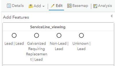

Thank you for bringing this to our attention. That is happening because of the complex symbology (the split point using multiple attributes) of the service when it was published from Pro during development. Even though the Public map doesn't use the split point, the underlying feature service view (ServiceLine_viewing) does.
I have a fix, but I highly suggest testing it in a test environment as it will involve renaming edit templates, which I know from experience can be fragile. Also, only do this in ServiceLine_viewing and not the other services/views. Please follow the steps below:
  1. In the Contents of the Lead Service Line Inventory folder, click ServiceLine_viewing
  2. Click the dropdown arrow next to "Open in Map Viewer" and click "Open in Map Viewer Classic with full editing control". This will allow you to adjust the edit templates of the view even though the view doesn't have editing enabled.
  3. ServiceLine_viewing will open in Map Viewer Classic. In the top left click Edit. AlexKabak_0-1692974269077.png
  4. At the bottom of the Edit pane, click Manage.

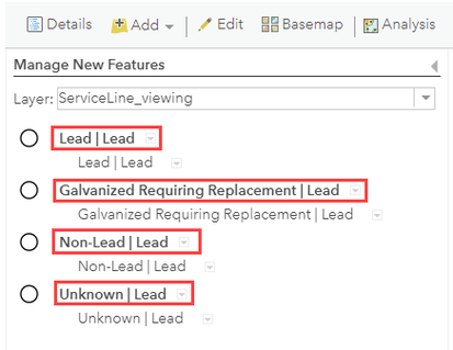

  5. You are now going to update the names of the edit templates. These are the names in bold and I have also put a red box around them in the image below. You do not need to update the names beneath them. AlexKabak_1-1692974464752.png
  6. Click the dropdowns next to the names in bold and click Properties. Update the label by removing " | Lead" and click Done.
  7. After making the changes to the 4 edit templates, at the bottom of the pane click Save Changes. This will save ServiceLine_viewing.
  8. Open Lead Service Line Public Viewer app and confirm the update worked.
