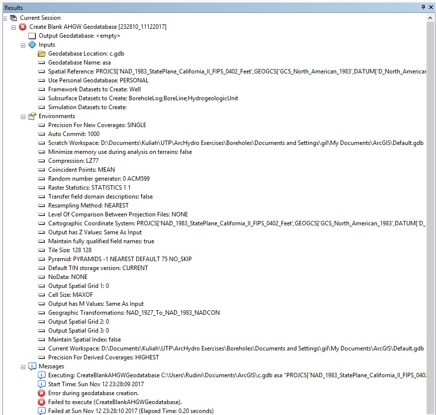

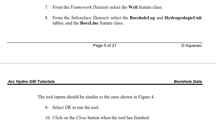

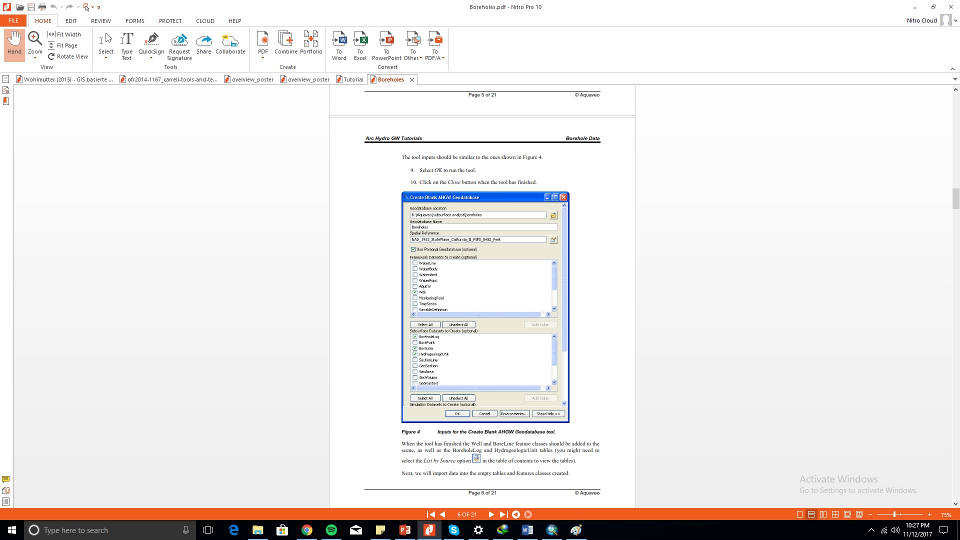

i using archydro toolbox to make 3D borehole data.
when i looked the tutorial how to make 3D borehole data i found this link (Arc Hydro Groundwater Tutorials | Aquaveo.com) i choose "working with borehole data" the and start following the tutorial.
but i have some problem when i tried to follow the tutor (see images below)
when i tried in ArcScene 10.2, i always got this error (image below)
can anyone help me with this issue?? because i tried figure it out but get stuck what the error is..
thank  you
PS: does anyone know how to visualize the well data into 3D with another way??
DanPatterson_Retired
MVP Emeritus
well, it appears from the first two lines way up in the processing you are tryig to create a geodatabase in a geodatabase rather than a folder.

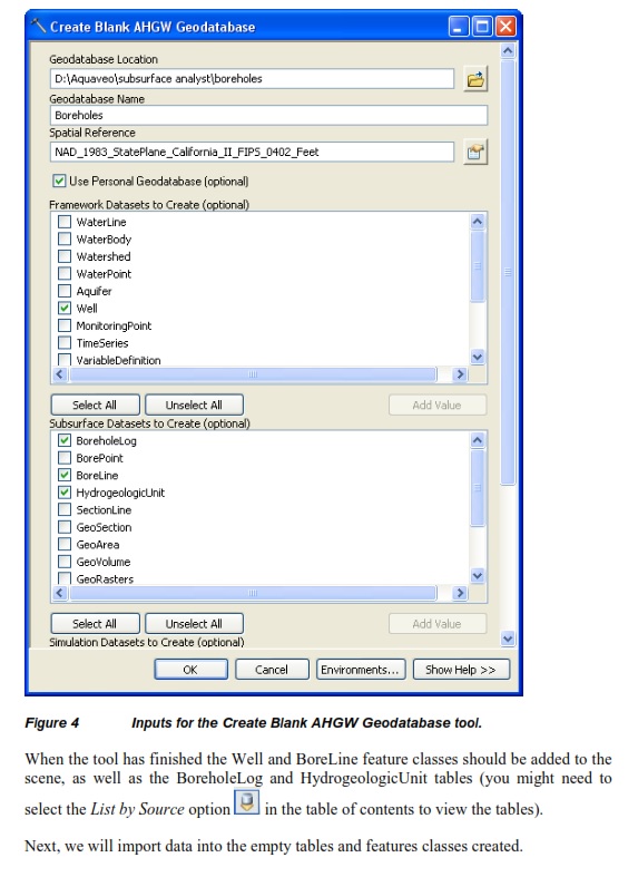

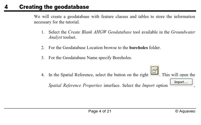

so this is the tutorial from the website that i attached in above
so in the dialog box i just follow what it said.. the tutorial geodatabes is on .mdb file. should i use .gdb file??

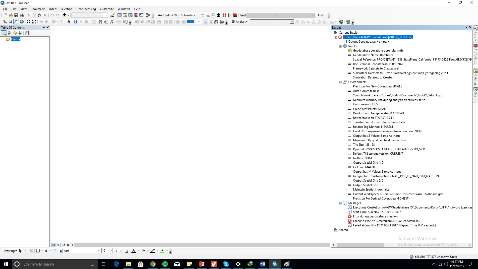

and got result like this.. (using .mdb file)

It must be an old tutorial.  Also, the destination mdb .... put it somewhere shorter as suggested.  and your current workspace is a gdb instead of a folder
RudiniRudini
still had same error..
RudiniRudini
ah i see.. solved now..
thank you very much Mr Patterson
