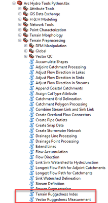

I've downloaded ArcMap 10.8.0.33 and the 10.8.0.34x64 version and the Terrain Ruggedness Index isn't listed, nor the Vector Ruggedness Measurement for either version. All of the other tools seem to be there, however. I'm not sure if it's a version problem. Has anyone found this as well? Thank you!
DeanDjokic
Please make sure you look into "Arc Hydro Tools Python" toolbox under the "Terrain Preprocessing" toolset.  They should be there at the bottom of the list.
