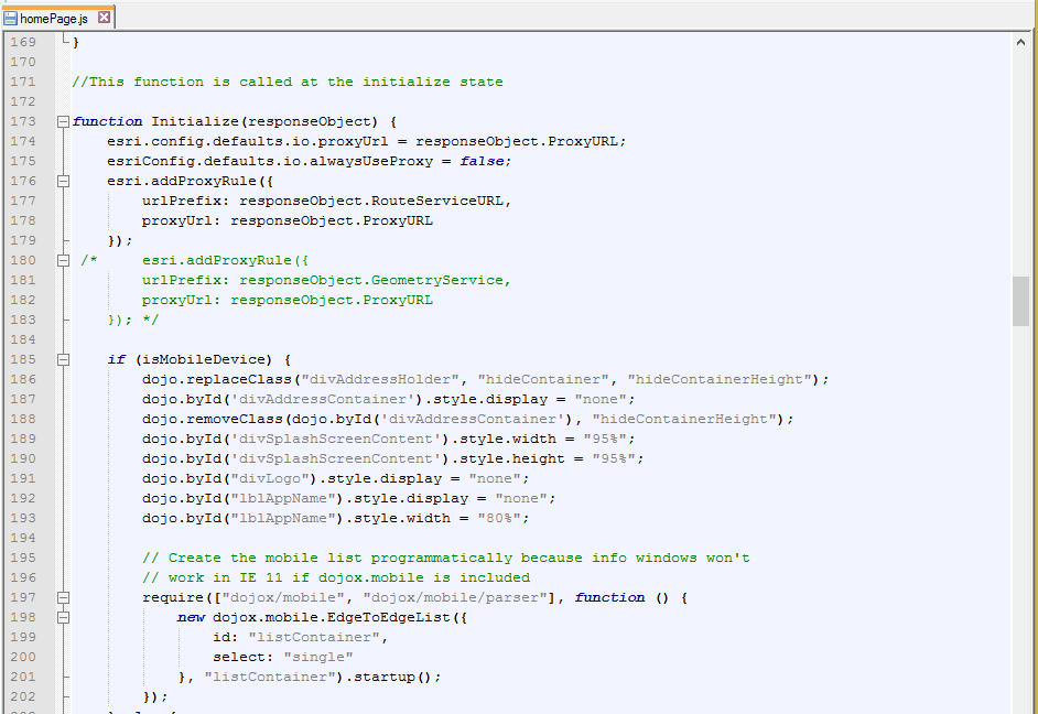

Hi Daniel,
The issue I had was that the geometry server which is used with the polygon layers was being forced to go through the proxy which I was not using. I spent a lot of time back and for with ESRI tech support (thank you Chen) and we got it working by disabling the proxy through the code. In the application folder go to js/homePage.js file and comment out the code below:
     esri.addProxyRule({
           urlPrefix: responseObject.GeometryService,
           proxyUrl: responseObject.ProxyURL
In my file is was lines 180-183. Try that and see if it helps.
