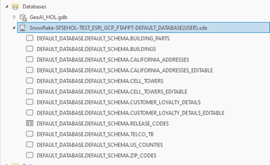

Step 1: Connecting ArcGIS Pro to Snowflake
Open your ArcGIS Pro project and follow these steps to set up a live connection to Snowflake.

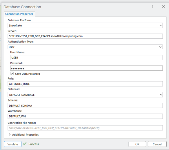

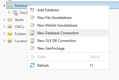

  1. Open the Catalog Pane
  2. Right-click on Databases, then select New Database Connection.
  1. For Database Platform, choose Snowflake.
  2. Provide the full server name, which includes .snowflakecomputing.com.
  3. Select your Authentication Method and enter your credentials.
  4. Fill in the Role, Database, Schema, and Warehouse.
This connection does not require any data replication. ArcGIS Pro pushes SQL queries directly to Snowflake and displays the data returned, making it ideal for working with large datasets.
Once connected, you’ll be able to explore your Snowflake schema and see which tables are spatial and which are non-spatial.

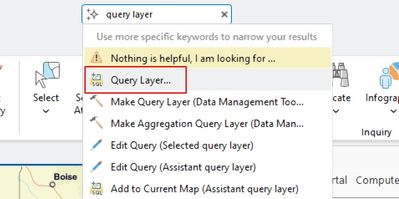

  1. In the Command Search Box, type Query Layer.
  2. Click Query Layer, and select your Snowflake connection.

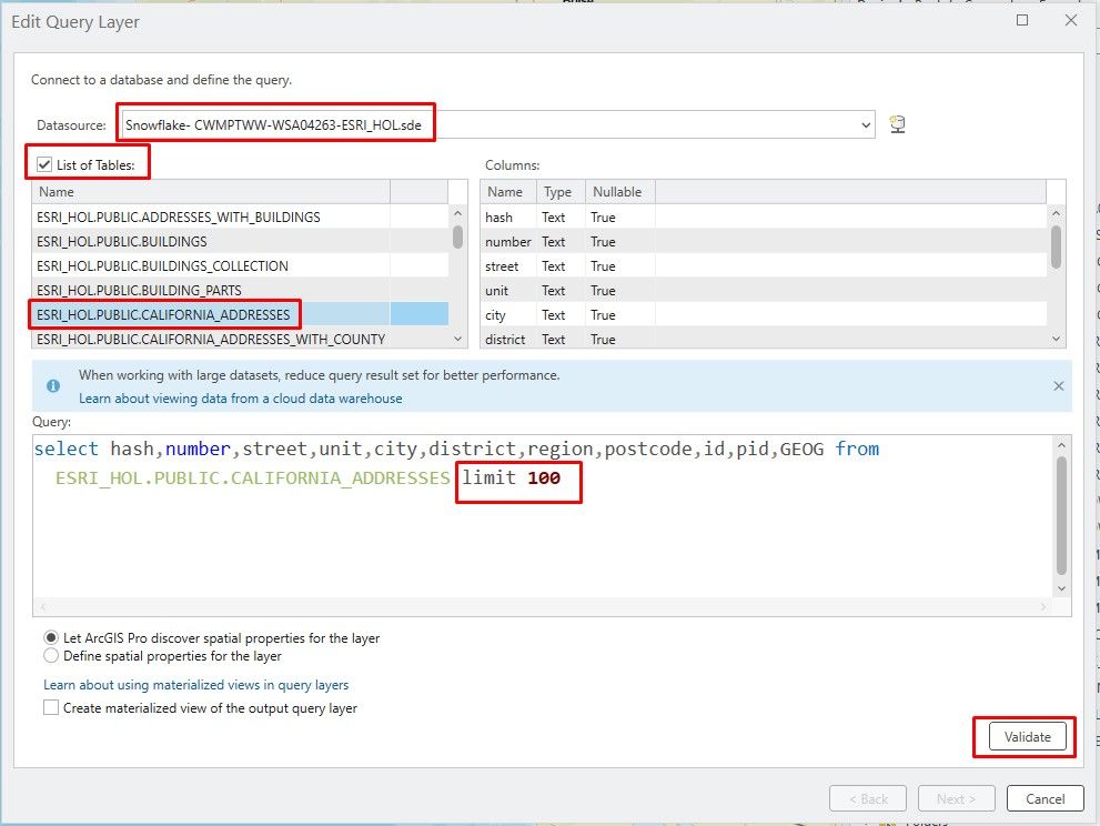

  1. Enable the List Tables checkbox and select ADDRESSES  table.
  2. ArcGIS auto-generates a SQL query, you can add the LIMIT 100: SELECT * FROM CALIFORNIA_ADDRESSES LIMIT 100. This retrieves a sample of 100 records.
Click next

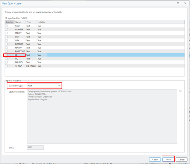

  • Set the unique identifier field (e.g., ADDRESS_ID)
  • Choose Point as the geometry type
This query layer now dynamically fetches Snowflake data and renders it on your map as a spatial layer—without duplication.

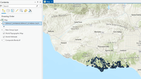

Step 3: Filtering Query Layer by City
Next, let’s zoom in on a specific city—Malibu.

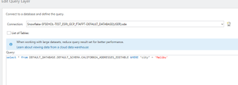

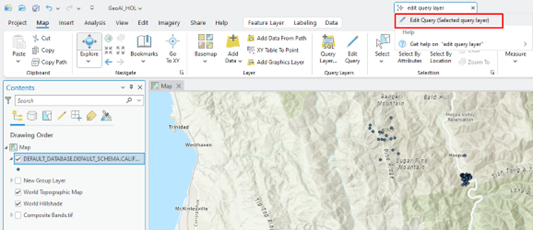

Edit your query layer using the Edit Query tool. To the command box and type edit query layer.
Replace the SQL with:
SELECT *
FROM DEFAULT_DATABASE.DEFAULT_SCHEMA.CALIFORNIA_ADDRESSES WHERE city = 'Malibu'
This modified layer now only displays customer data for Malibu. Query layers push the SQL logic directly to Snowflake, ensuring minimal latency and maximum performance.

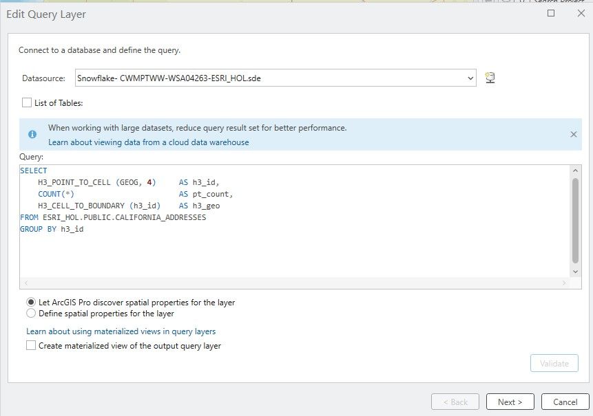

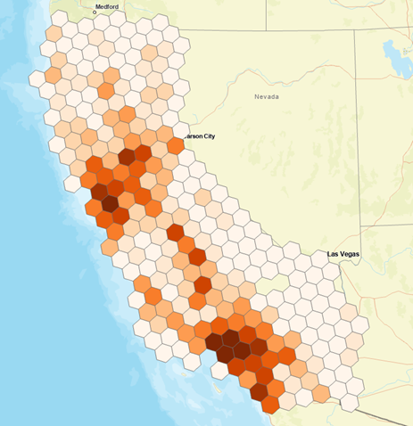

Step 4: Aggregating Data Using H3 Spatial Functions
To analyze density, we’ll aggregate customers into hexagonal bins using H3 geospatial functions (available in Snowflake).
Create a new Query Layer, select the Table CALIFORNIA_ADDRESSES and enter this:
SELECT
H3_POINT_TO_CELL("GEOG", 4) AS h3_id,
COUNT(*) AS pt_count,
H3_CELL_TO_BOUNDARY(h3_id) AS h3_geo
FROM
DEFAULT_DATABASE.DEFAULT_SCHEMA.ADDRESSES GROUP BY
h3_id
Explanation:
  • H3_POINT_TO_CELL maps a point to a hexagon at resolution 4.
  • COUNT(*) counts how many customers fall in each bin.
  • H3_CELL_TO_BOUNDARY returns the polygon geometry for each hex bin.

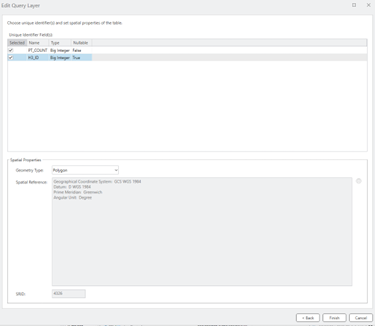

Set:
  • h3_id as the unique ID
  • Geometry type as Polygon

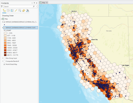

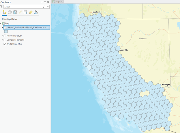

ArcGIS will take the geometries and render the aggregated map
Now you’ve created an aggregated density layer driven directly by Snowflake and powered by spatial SQL. Use Graduated Colors symbology to visually identify hotspots.
From the Contents pane, right-click on the layer and choose Symbology.
Here, you will allow the count of the points in each bin, to be used to drive the colors.
  • Select Graduated Colors.
  • Select 10 classes.
  • Select the PT_Count as the Field.

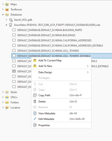

  1. In the Catalog Pane, under your Snowflake connection, right-click on CELL_TOWERS_WITH_RISK_SCORE.
  2. Click Add to Current Map
  1. Use CELL_ID as the unique identifier.
  2. Set geometry type to Point.
