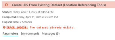

We are attempting to rebuild our LRS in a new database that was set up with three tier security and are running into an issue with the Create LRS from Existing Dataset tool. Our understanding was that we could already have all of the data copied into the new database, but not set up as an LRS yet. We are getting an error that says the dataset already exists, so is there a different tool that we should be using?

@CharlotteMays_10  please check the tool parameters used. Specifically the LRS Name
The name cannot already exist in the geodatabase. Also, it is best to configure LRS against the schema (without the data). You may run into additional errors if the data is pre-populated.
  • Minimum schema items are used for the centerline, centerline sequence, calibration point, and redline feature classes. Ensure that the items are empty, contained in the same geodatabase, and not used by another LRS in the geodatabase. REF: Create LRS From Existing Dataset
