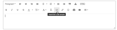

JaredCaccamo
Hey @EricAtkinson1 ,
Just to let you know that you can click on the insert code button so that it doesn't break it down into block by block. Will make for more readable code on geonet. Take a look at the picture below.
