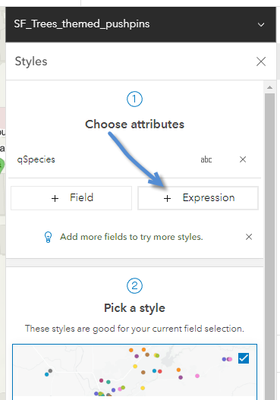

In mapviewer choose Attributes set an Expression
Or in ArcGIS Pro
You can set symbology for each returned result from your expression.
