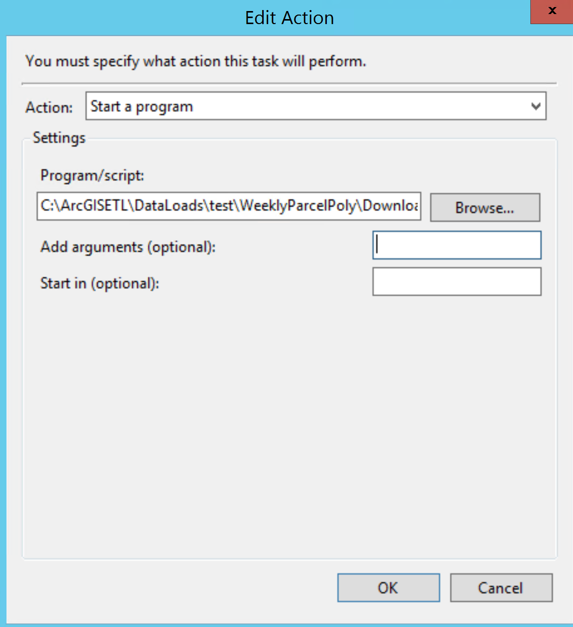

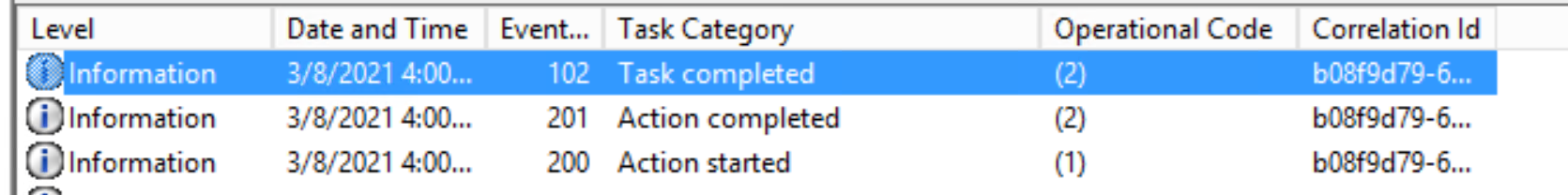

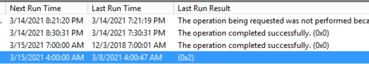

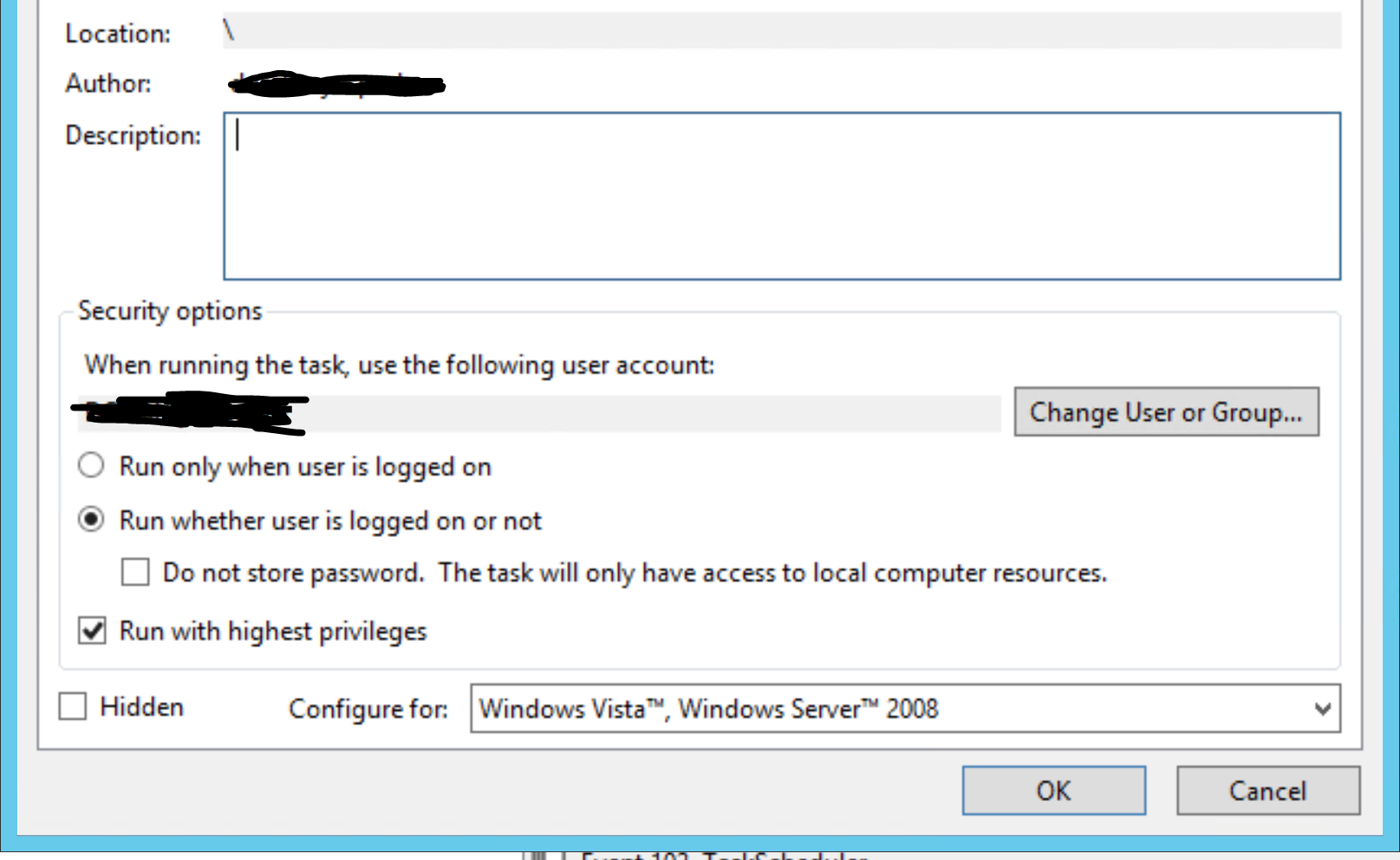

I am stuck. I have python 2.7.16, ArcGIS Pro 2.7.1 and ArcMap 10.7.1 on the machine. I have a python script stand alone. It said it already run but then I have an error (0x2) with window task scheduler. I provided screenshots and one of pieces python script below. Please advise. I can provide more screenshots / info if needed.

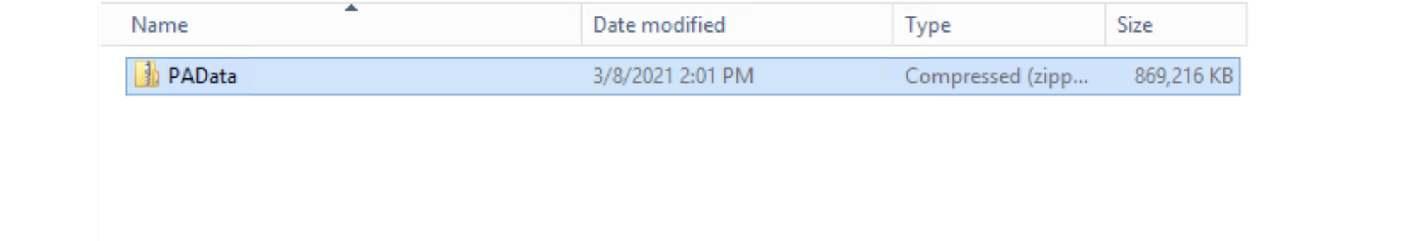

It used to work but now I am not sure what is going on. It needs to be download zip file folder and extract it all from ArcGIS online to windows machine. It is actually working download zipped folder but it doesn't work to extract it all anymore.
UNDER ACTION TAB:
#1 START A PROGRAM:
Program/script:
C:\ArcGISETL\DataLoads\test\WeeklyParcelPoly\DownloadPAData.bat

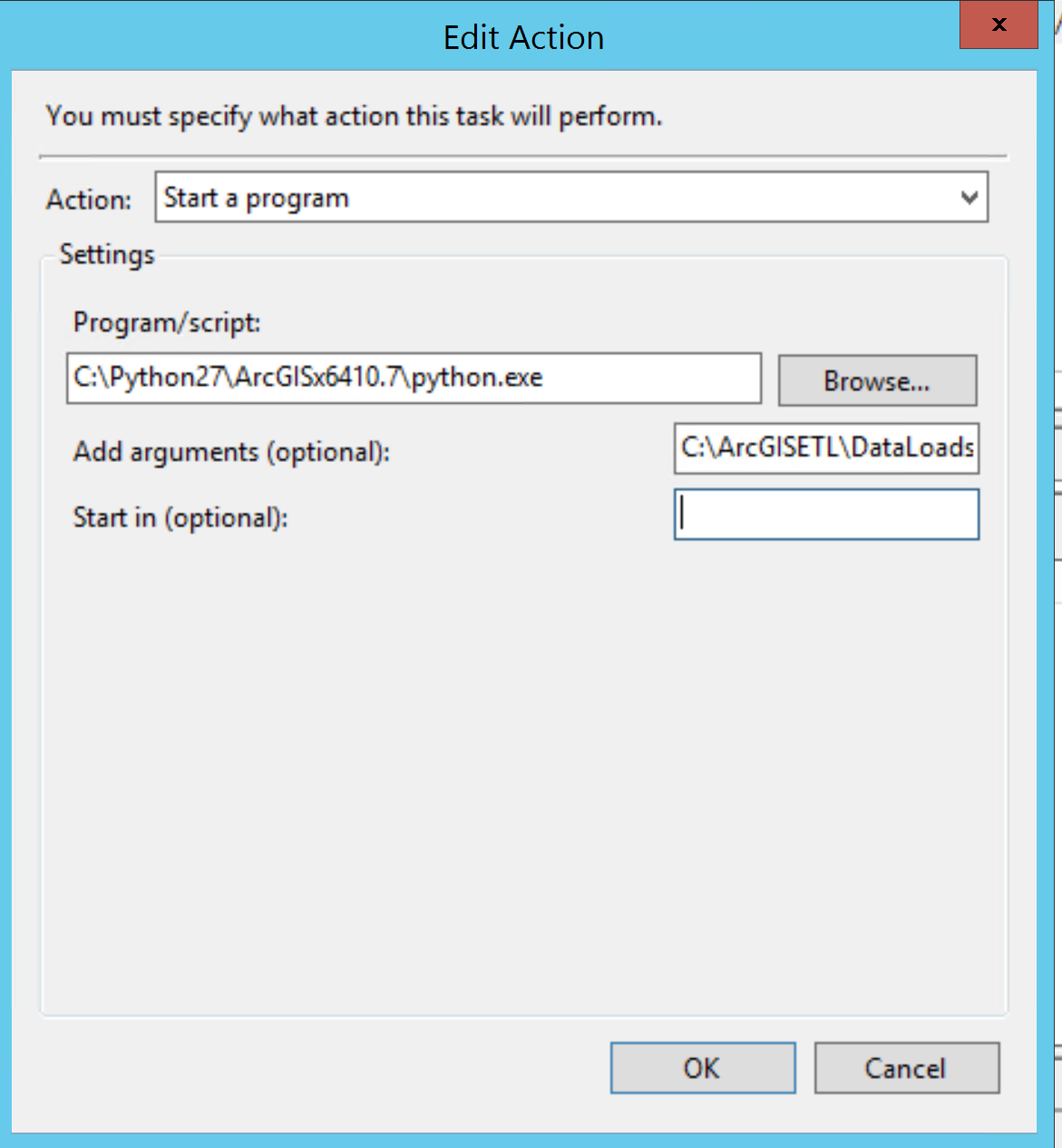

#2 START A PROGRAM:
Program/script:
C:\Python27\ArcGISx6410.7\python.exe
Add arguments (optional):
C:\ArcGISETL\DataLoads\test\WeeklyParcelPoly\test_Weekly_GDB_OpenData - Copy.py
