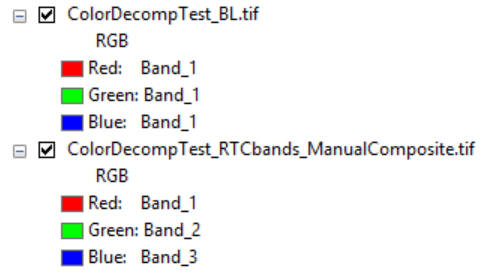

This is what the outputs look like in the TOC. The top one is the raster generated by the script, the bottom one was generated manually using the tool interface in ArcMap. The rasters are identical in terms of pixel values in the RGB bands.

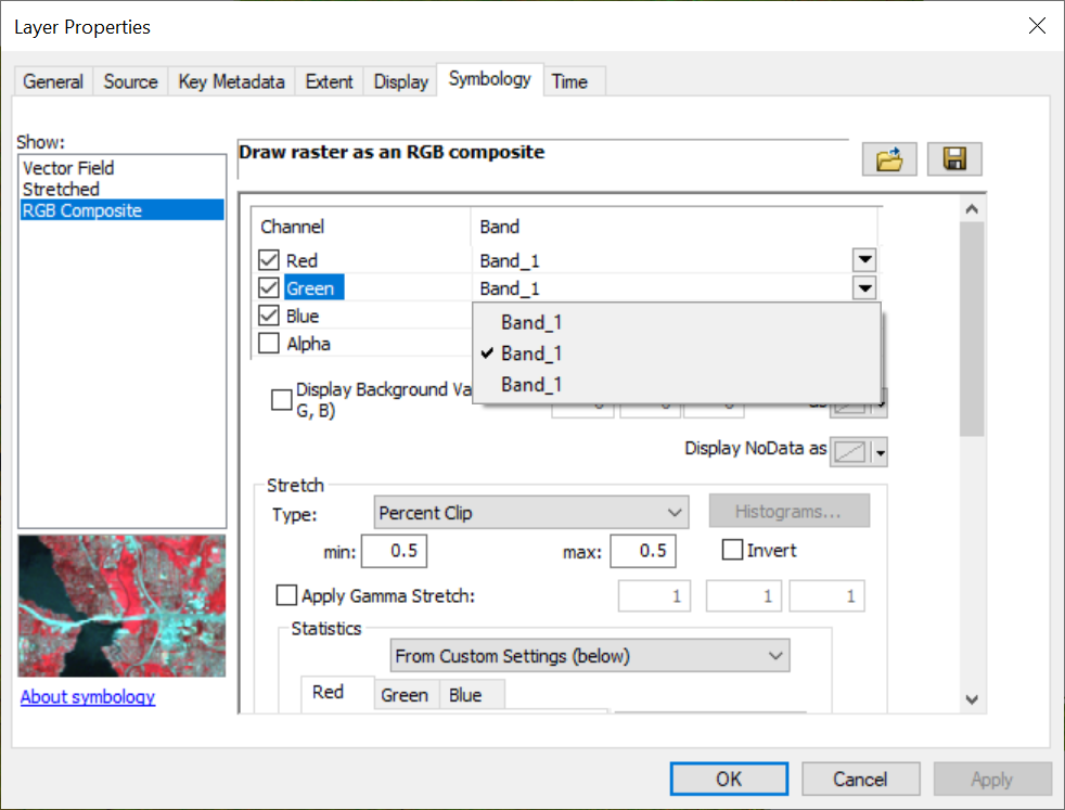

If you open the properties of the composite raster, you can see that there are 3 different bands to choose from, but they're all called Band_1. If you change the green band to the first Band_1 listed instead of the second, the image behaves as you would expect if you changed the green band (Band_2 in a the tool-generated output) to the red band (Band_1 in the tool-generated output). Likewise, the statistics for each layer (Red, Green, Blue) match those for the appropriate input single-band raster. It really does appear to be only the naming that's off.
