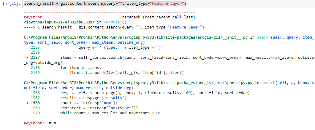

Hey All- I have a public REST service that has several layers and feature classes that I want to access. According to the documentation. Once I have the 'arcgis' package imported, I can inject my outside REST service as such:
 *Note: I am using the Jupyter Notebook to test this code.
from arcgis.gis import GIS
gis = GIS("https://hazards.fema.gov/gis/nfhl/rest/services/CSLF/Prelim_CSLF/MapServer")

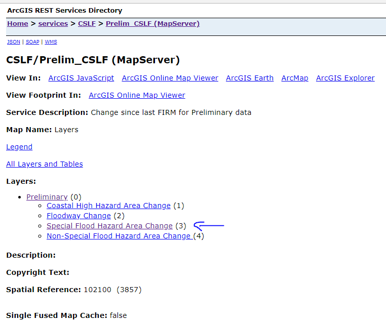

Since this is a public service, I didn't have to include any username or password parameters. The service has several layers (item_type="Feature Layer) that I want to access; namely Special Flood Hazard Area Change layer, but perhaps others:
Using the example from the API docs, I tried to do a search in the service just to see all the layers and any info I might need in future calls. I am using the '.search' method from the content manager.
# search and list all feature layers in my contents
search_result = gis.content.search(query="", item_type="Feature Layer")
search_result
Every time I try this, I get an either a KeyError='num' or a TypeError: must be str, not int (if I try to add a query). What am I doing wrong here and what is the proper way to search within this REST service?

According to API Reference for the ArcGIS API for Python — arcgis 1.4.2 documentation, a GIS object "is representative of a single ArcGIS Online organization or an ArcGIS Enterprise deployment," and the "constructor constructs a GIS object given a url and user credentials to ArcGIS Online or an ArcGIS Enterprise Portal."  The service you reference is not part of ArcGIS Online or an ArcGIS Enterprise Portal, it is a map service published from an unfederated ArcGIS Server.
If you are interested in accessing the properties of an individual map service, you can use the arcgis.mapping module — arcgis 1.4.2 documentation:
>>> from arcgis.mapping import MapImageLayer
>>> mil = MapImageLayer(r"https://hazards.fema.gov/gis/nfhl/rest/services/CSLF/Prelim_CSLF/MapServer")
>>> for lyr in mil.layers:
...   print(lyr.properties["name"], lyr.properties["type"])
Preliminary Group Layer
Coastal High Hazard Area Change Feature Layer
Floodway Change Feature Layer
Special Flood Hazard Area Change Feature Layer
Non-Special Flood Hazard Area Change  Feature Layer
