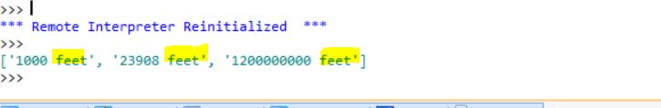

I am trying to with a script that replaces the word "feet" to "meter" in a list:
AreaList = ["1000 feet", "23908 feet", "1200000000 feet"]
for area in list(AreaList):
       area.replace("feet", "meters")
print AreaList
but I still see the results as the following:
the word feet still in the list! what might be my mistake ?
Thanks

Thanks Mitch this worked fine with me, also I figure out where the error was in my code, it should be written as this:
    area=area.replace("feet", "meters")
    print area

You printed AreaList, which doesn't get changed even though you would be printing and changing the values as you went.
>>> a = [i.replace('feet','meters') for i in AreaList]
>>> a
['1000 meters', '23908 meters', '1200000000 meters']
Now see what went wrong.
>>> for i in AreaList:
...      i = i.replace('feet', 'meters')  # note the reassignment
...      print("i value {}".format(i))
i value 1000 meters
i value 23908 meters
i value 1200000000 meters
>>> print("Area list at the end \n{}".format(AreaList))
['1000 feet', '23908 feet', '1200000000 feet']
Got to watch what you think is going on... just because a value is pulled from and list and changed, doesn't mean the value in the original list gets changed.  You have to recollect the changes as I did in the original example, or replace them in the input list.

The string.replace() function does not change the string in place, it returns a new string with the replaced words.

Ahmad SALEH, it is possible in Python to update list values in place, as opposed to constructing a new list, which is what a list comprehension does.  Looking at your original code, incorporating enumerate() allows you to keep your basic code structure and do the updates you want:
>>> for i, area in enumerate(AreaList):
...     AreaList[i] = area.replace("feet", "meters")
>>> print AreaList
For your specific situation, I think using a list comprehension makes more sense because you will be updating every list item.  In cases where the number of elements updated in a list is high, especially when nearly all elements are updated, constructing a new list and reassigning it back to your variable of choice often makes more sense then doing in-place updates.
