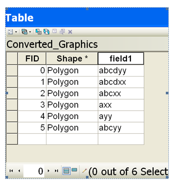

use the field calculator to create a python code snippet to remove the last two characters from the values in field1
2802
6
12-11-2017 10:45 AM
CourtneyWade
I am working on an assignment for my programming class (a class that I’m greatly struggling in) where I need to use the field calculator to create a python code snippet to remove the last two characters from the values in field 1. I know there are similar questions on this forum, yet I’m finding it hard to apply those suggestions to my problem.  Any guidance would be very much appreciated.
Thank you in advance.

In python, strings are iterables... in the field calculator use the python parser and it would be
!YourFieldNameHere![:-2]
of course you have to calculate this value into a new field
a = 'asdfasdfasxx'
a[:-2]
'asdfasdfas'‍‍‍‍‍
Now you didn't specify whether it is possible that the field would contain less than 2 characters.  This is a simple field calculation, so normally you would use a field calculation
and call it with
cal(!YourFieldNameHere!)
def cal(a):
    """ replace the last two characters in a field"""
    if len(a) > 2:
        return a[:-2]
    else:
        return 'Read the docs'
CourtneyWade
Yes, Dan! I got it!!! Thank you! I guess I didn't realize I needed to make a new field (makes perfect sense now). I was trying to 'correct' the existing field without any luck. You helped me one other time too....I appreciate you taking the time to answer my question.

MicahBabinski
Hi Courtney,
Dan's got you covered for using the codeblock parameter within Calculate Field. It's not clear to me if your assignment requires you to use that parameter. If not, you could just run:
arcpy.CalculateField_management("Converted_Graphics", "field1", "!field1![:-2]", "PYTHON_9.3")
Keep at it. The GIS programming stuff gets easier with time, trial/error, and repetition.
Micah
CourtneyWade
Hi Micah! Thank you for your suggestion. I was able to try your method on the next question and was able to make it work too.  It's is nice to know a few different ways to 'skin a cat'. My class is completely online so I'm kinda on my own here. I really appreciate you taking the time to answer my question.
