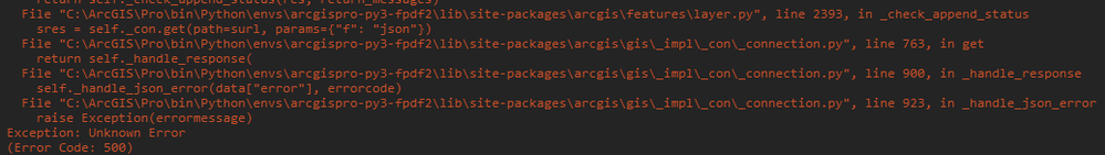

In line 77 you are passing the following paramater:
source_table_name=lyr
But lyr on the code is the layer you get from GetWebLayer (layers from AGOL's folder). That parameter must be the name of the layer in the geodatabase you just uploaded. Unless they're called completely equal it's going to output an error 500. I managed to reproduce your error passing an unexisting layer in that parameter:
Hope that helps!
